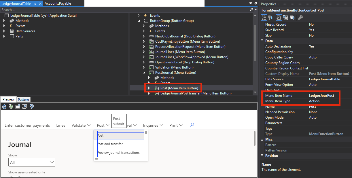

    While access to the Vendor Payment Journal page is controlled by the LedgerJournalTable5 menu item display, the Post button is controlled by the LedgerJourPost menu item action. So for the first scenario you should assign Create permission to the LedgerJournalTable5 menu item display and either no access or deny access to the LedgerJourPost menu item action and for your second scenario you should assign Read access to the LedgerJournalTable5 menu item display (and potentially deny access to Update/Create/Delete) and then any level of access to the LedgerJourPost menu item action.

    In my post I provided a screenshot of the form in the AOT (in Visual Studio on a developer environment), this allows for a user to navigate the form and be able to see the objects tied to the individual menu options. This allowed me to find the object tied to 'Post' menu button which was the LedgerJourPost menu item action.
    Unfortunately this type of information is difficult or sometimes impossible to find through the UI and you have to go into the development side to be able to gather the data.
