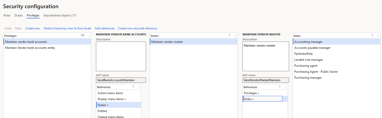

    please can  anyone guide me how can I find a specific privilege available in security roles
    Eg, Looking for a privilege 'Maintain vendor bank account" privilege in available in which security roles

    Najeem,
    Normally this process natively is somewhat tedious as there isn't a role -> duty -> privilege report available out of the box so you have to use the Security Configuration report and find the privilege and then go to each duty it is assigned to see what roles those are assigned.
    Fortunately in this case, the privilege is only assigned to one duty which makes this process slightly easier:
