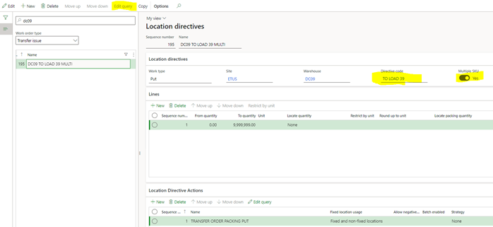

    Single SKU transfer orders are not an issue since the Edit Query button is available on the Location Directives screen. I can designate the To Warehouse on that query do the put to the location we want.

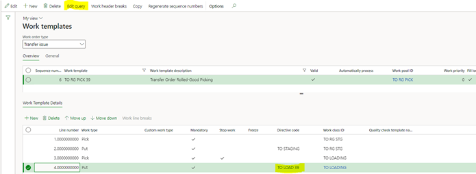

    But for Multi-SKU location directives, the Edit Query is grayed out. You cannot designate any parameters on the location directive. It appears you must link a Directive Code to the Location Directive, which is then linked to a Work Template where you can then designate in the Edit Query which Ship to Warehouse it is for. Start multiplying all of the combinations of Location directives, times the number of Directive codes and the Work templates, and the number of setups begins to add up to hundreds.

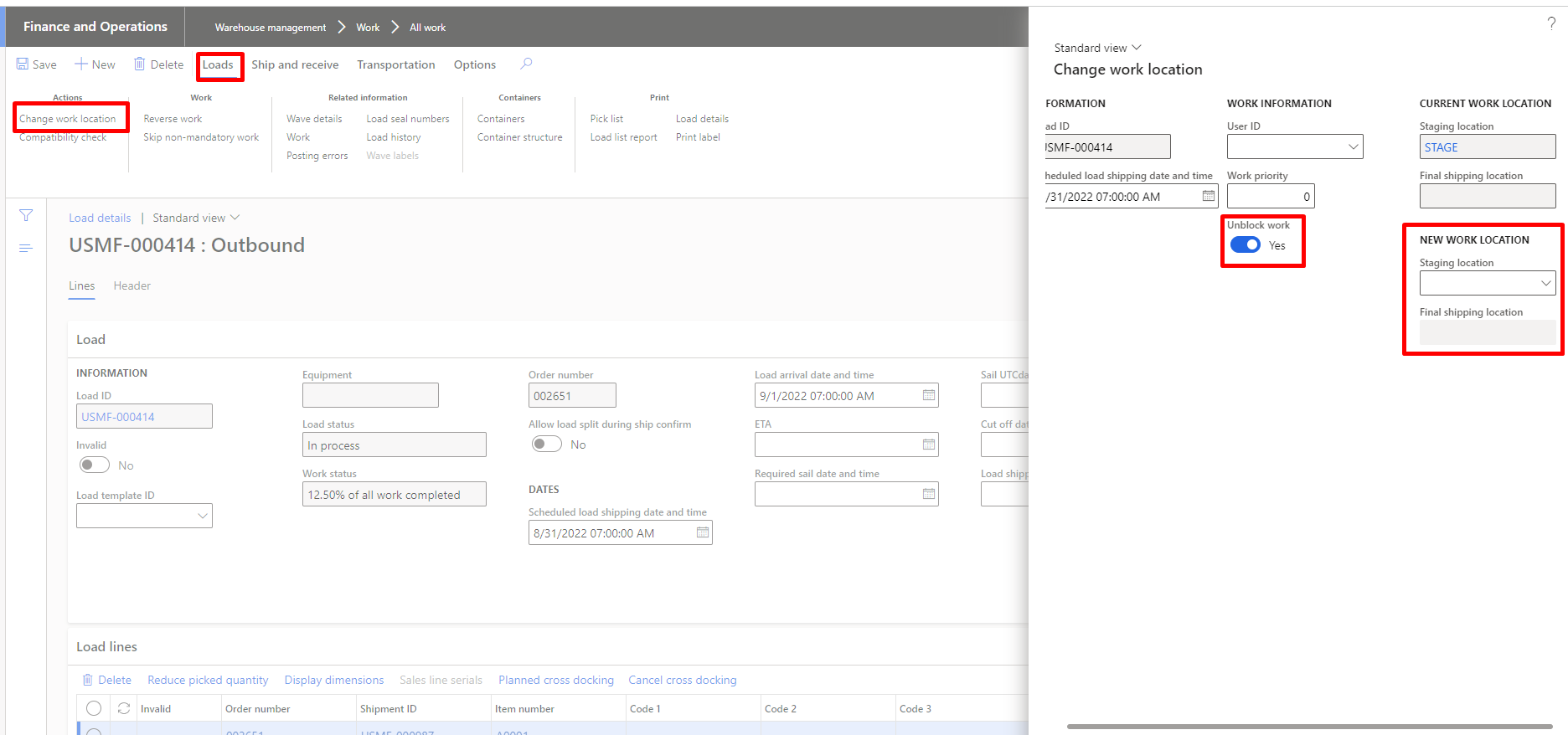

    2.) Let the PUT to STAGE and PUT to Door create with a blank locate or dummy locate, have the Wave template "Automate wave release" = No, this will cause the wave to process to a "Held" state.  Have a supervisor / transportation coordinator type person review the loads associated with the Wave, on the Loads tab in the action pane -> Change Work Location and assign a Stage bay and final shipping location, with "unblock work" ticked.  This will move the wave / load from a held to released status and have the locates that are available based on where you lined trucks up that day.
