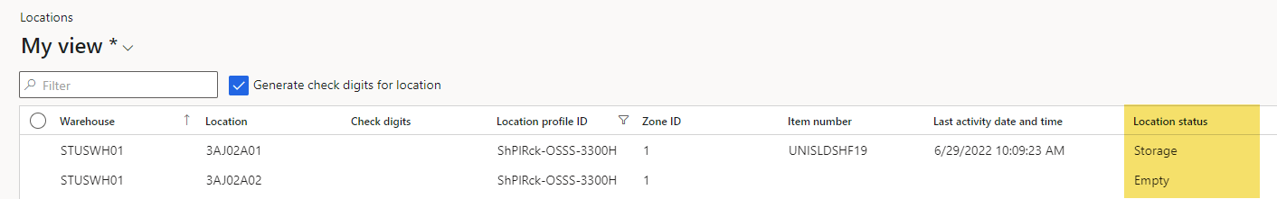

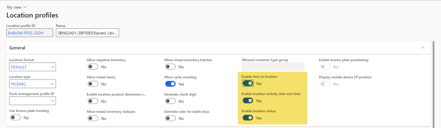

1. The location status should tell you if your locations are empty, but I believe the status would be showing based on Physical Inventory qty, not Available Physical. Have you confirmed that the location profiles have these fields enabled?
- I have seen where the location status will show as Undetermined if only the 'Enable location status' flag is set to Yes, but enabling all 3 flags adjusted the location status to show Empty
Here's an example what I see in the locations module:

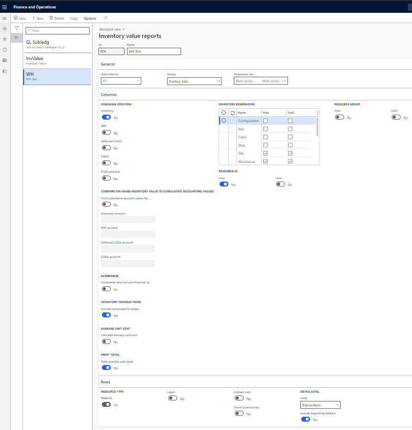

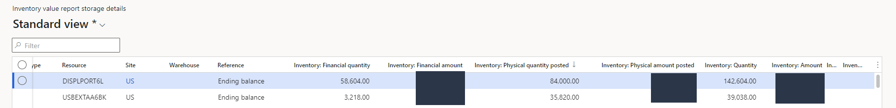

2. You may want to check out the 'Inventory value report storage' feature, which does a decent job of summarizing. I read that these transactional reports once stored can be exported to external systems, but have not looked into how that is done.
e.g.
Parameters used for the above report:
