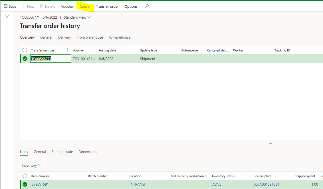

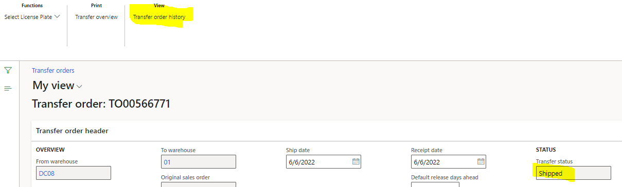

    Earlier this year we enabled the new feature management for Transfer Order Cancellation. From my looking at this, if a transfer order is in a status of Shipped, but not received, the transfer order should be able to be cancelled through the transfer order history-cancel button. The cancel order but is grayed out and we are not able to use the functionality. Is there some other setting that needs to be updated to make this functionality fully functional?

    It is still purely in shipped status. No registrations or receiving. I have it in our test environment and just rechecked it to make sure. Still no cancel button.

    Thanks for the suggestion Andrew, but I am definitely not seeing anything registered.
    And just for the record, the Cancel button is still grayed out.

    I can't recall, but does the feature work only after shipment/load has been processed? I.e. is it possible the Transfer order inventory transaction has Shipped, but the Load/shipment are still in "Loaded" status and that's preventing it from being cancelled?
