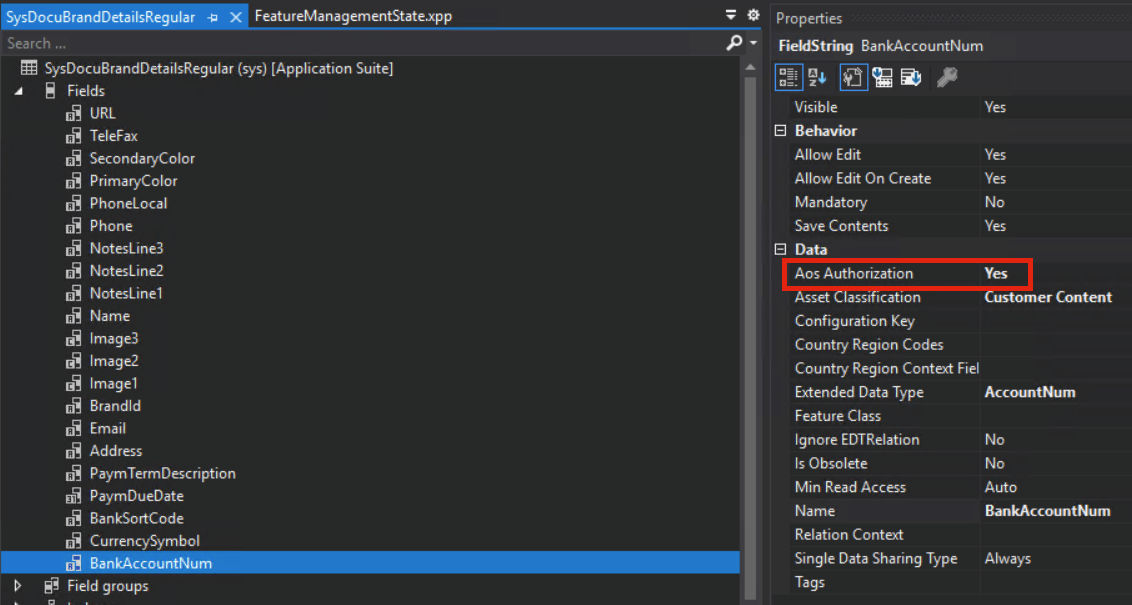

    Amber,
    This is more than likely caused by the table permission framework functionality being applied to this field (AosAuthorization set to true). Because of this, a user must have explicit access to this table field and cannot get derived access from access to the menu item or table. I go into how this feature works in the blog post here: https://alexdmeyer.com/2019/01/24/table-permission-framework-in-d365fo/

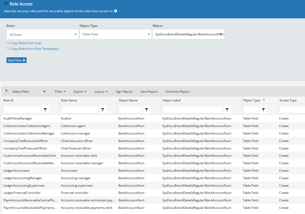

    Amber,
    There is no way to do this easily within D365FO (running a report to see which roles have access to a certain object). You can potentially get there running a report via the AOT like I do in this blog post: https://alexdmeyer.com/2017/04/13/security-reporting-for-dynamics-365-for-operations-in-the-aot/
    However, I executed a query in the Fastpath security access tool and was able to generate a list of roles that have explicit access to that table field:
