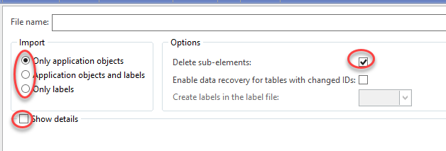

    Please can any one advise steps and check marks to export and import project (code or script) from Test environment to Prod environment
    Any check mark required
    EXPORT
    Import
    what are the next steps like:
    -Generate full CIL or
    -Increemental CIL
    -Does Sync required
    Please advice

    First of all, please take into account that importing code from a project in Production is not recommended. A best practice is to deploy the updated models.
    Having said that, if you're exporting/importing projects, the recommendations with regards to checkboxes would be:
    EXPORT:
    - Application Object Layer = Yes
     Select the layer from where you want to export your modifications. If you're a customer, this would typically be CUS or USR.
    - Export Labels : Select only when you've created new labels as part of your development. Please be aware that importing/exporting labels is a bit tricky and not always works nicely.
    Again, ideally labels files should be deployed to prod instead of labels being installed via projects.
    IMPORT:
    - Delete sub-elements = NO
    - If you've exported with labels --> Select "Application objects and labels", otherwise "Only application objects".
    - Show details will show you which objects are going to be imported, but it won't have any effect on the import process itself.
    With regards to the next steps:
    - Full compile
    - DB sync if your project includes data model elements
    - It should be enough with incremental CIL compile, although I would recommend full CIL.
    - If you're transferring labels, a label cache clean may be needed (or alternatively a restart of AOSs)
