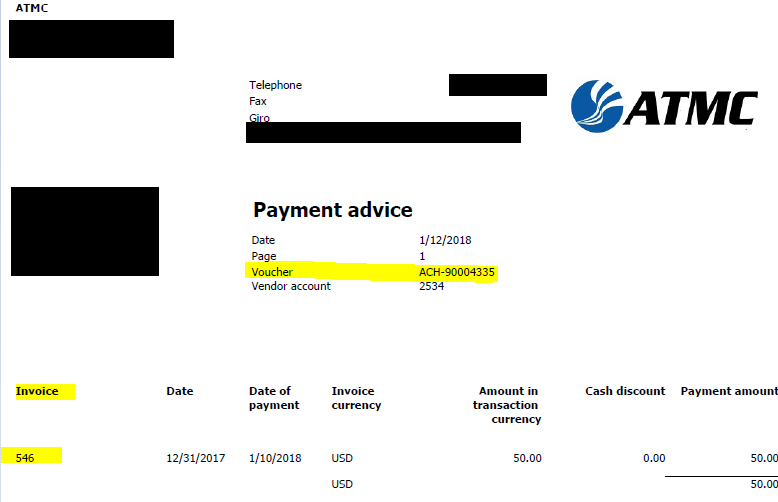

    ​If I understand your post correctly ....
    We simply made our ACH voucher series match the number sequence of the ACH 'check' numbers. So when an ACH was generated it would be as follows
    ACH-900001
    ACH-900002
    Etc etc.
    In addition to this, we added the voucher series to the payment advice (for ACHs) report to be reflected as a 'check' number.
    Now within the payment advice you will have the invoices broken down.
    I have posted a screen shot to help explain our solution.
    This was a small customization that ended up working extremely well. We plan to have it automated so once the payment is processed, the corresponding vendor will receive the email of the payment advice, referencing their invoices to the payment.
