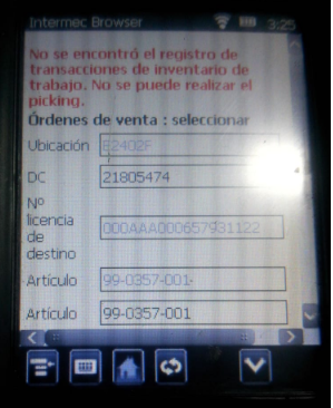

    We are using Dynamics AX 2012 R3 CU10, and sometimes we are experiencing an error when picking an item in the mobile device. The error states: 'Inventory transaction record was not found. Picking cannot be done'.

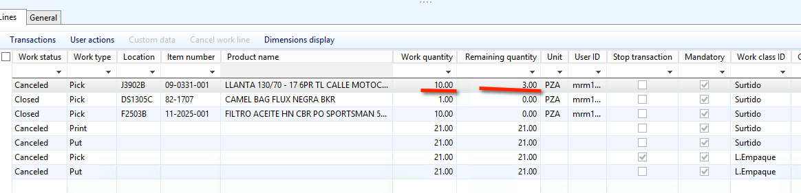

    We noticed that the quantity ordered is different to the one released to the warehouse.
    The sales order reserved 10 pieces, but when it was released to WH only reserved 7 pieces, however the work quantity created was 10 pieces, shown in the second image below. The inventory was available at that time.
    In the following image, the error on the mobile device is shown (It's in Spanish), it is a sales order picking work type:
    Error when picking with the mobile device
    In the following image, we see that the work indicates that there are 3 pieces in quantity remaining (we had to cancel the work, to release it manually again).
    Work error

    Mario,
    There could be a number of different issues. Here are some ideas.
    1. Review your location directives. We are set to only pick from fixed locations with items in available status. If a worker moves an item into a staging area and makes the status available, the sales order can reserve but no work will be created.
    2. Are the parts that were reserved tied to work that was in the middle of 'In process' (replenishment, inventory movement)? Until that work is complete, work will not be created but reservation can occur.
    3. If you are using fixed locations, are the items in the correct fixed location?
    Good Luck!
