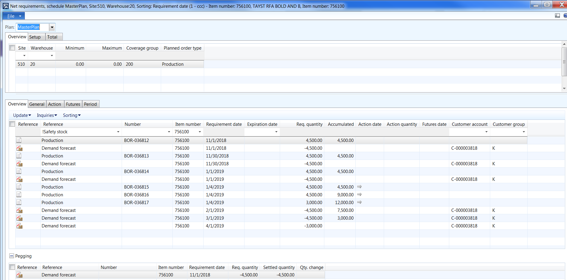

    ​​We have loaded the forecast for a finished good and use the net requirements window to review the planned production as well as the planned purchase orders for the raw materials of this finished good.
    We are trying to figure out why the Demand Forecast for Feb. 2019, March 2019 and April 2019 are being planned to produce Jan 2019.  Because the Production is not being scheduled in the correct month all of the raw materials we require to manufacture the item is being call for in Jan instead of the month the forecast is entered for.
    Any help or suggestions as to how Master Planning determines when to produce the demand forecast would be helpful

    Looks like some sort of calendar problem, where one of the calendars being used probably doesn't have 2019 built out yet. I'd check first under organization/workday calendars, because that's one that's easiest to overlook. You might very well have dates defined as open/closed going out for years, but you separately have to build the workdays in order to nail down shift start/end times.
    Less likely would be a specific resource constraint, though that again is probably a calendar issue, meaning the operation or job can't be scheduled into 2019 because of lack of available resources, so the production is planned early and using what's left of your 2018 capacity.

    Calendars is a great first check, as suggested. However, I would expect an error message saying the system couldn't find capacity to schedule if calendars ended: check your MRP session log if you haven't already.
    For the items in question, check coverage group setup to see if you are using period coverage for the impacted item(s). If you had a long coverage period, it would pull in orders from the first demand out that number of days: if you had 90 days, for example, you would build all 90 days of demand to the first requirement date.  Also check forecast plan setup.
    Some additional information about planning setup would be helpful if you haven't found the answer with these first couple responses.

    ​Calendars and Item Coverage are good to check but I would also suggest checking your routes. Your parts per hour could be setup incorrectly which could result in AX wanting to plan farther back in order to meet demand.

    Looking at the screen shot originally provided, it's surely not coverage group or route problems, as there are multiple planned orders scheduled roughly monthly with same volume. Also, the "resources can't be found" error message would only occur if the operation/job scheduling process failed to find ANY available resource, would not occur if resources were found, albeit months ahead of required date.
    If it's not a calendar issue, then a close second in my book would be a resource count issue, where some number of currently available resources are no longer available in 2019, meaning the resource/group assignment has an expiration date, but that seems pretty unlikely...

    ​Thank you everyone for your suggestions.  It was the Calendar setup that was being used in Master scheduling that was causing this issue.  Once we loaded the calendar for 2019 and reran master planning it scheduled the planned production in the proper month.
