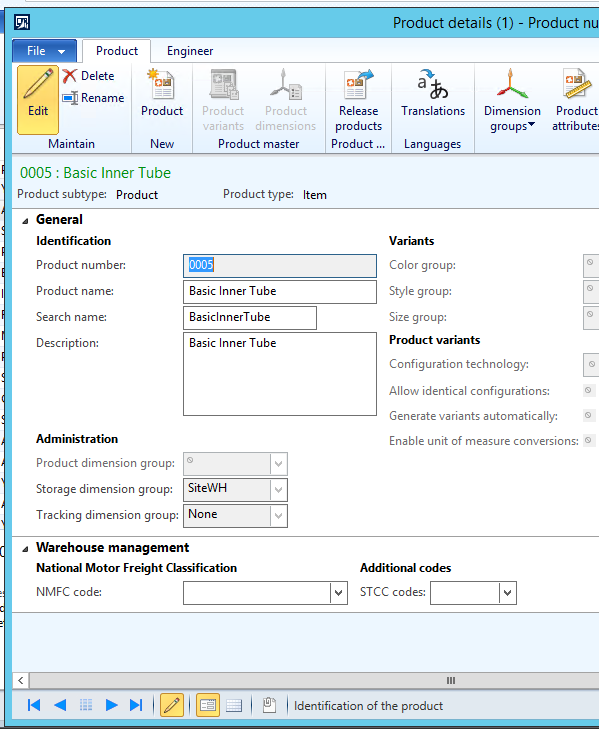

    Go to Product Info Mgmt -> Common -> Products -> All Products & Product Masters.
    Press the Edit in Grid button to launch the product details form.

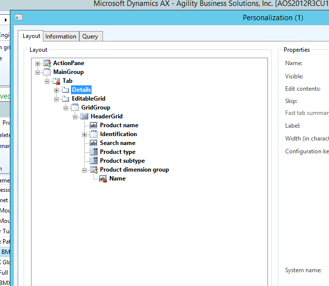

    Right click personalize here, but we are not going to use the "Add fields" button.  Expand the personalization form so you can see the whole tree on the Layout portion:

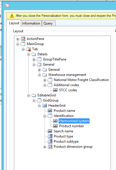

    Expand the Details -> General -> Warehouse Management -> Additional codes nodes until you see "Harmonized System".
    Left mouse click the Harmonized system field and drag it to the "Header Grid", just below "Identification".  Final result should look like this.  If it doesn't look like this, you may have placed the field in the wrong spot such that you can only see the data for one product at a time.

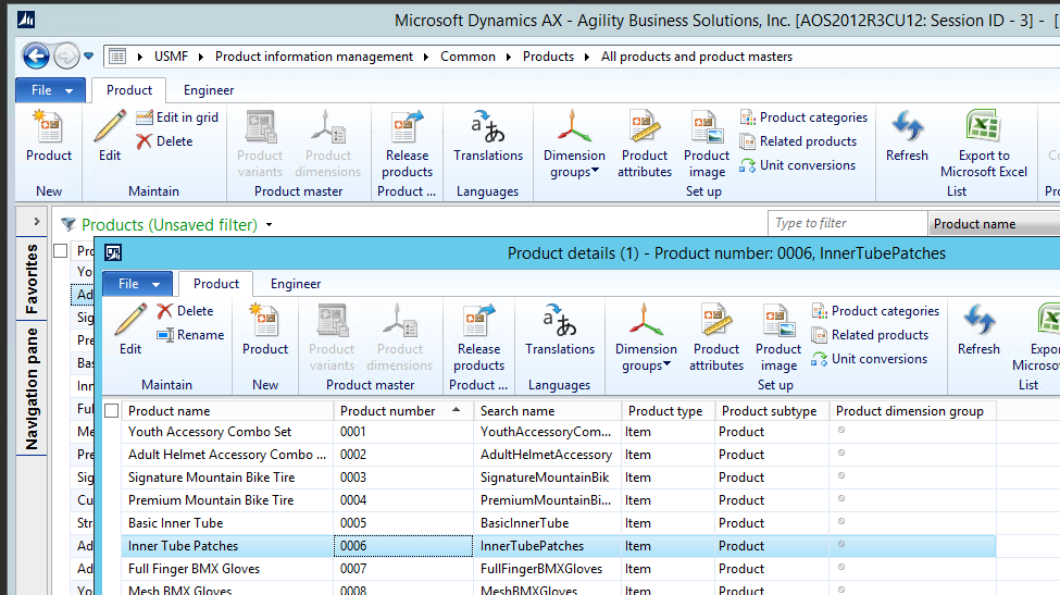

    Close the personalization form, and you'll notice you're product details form reverted to single product mode.  Hit the "Grid View" button at the bottom left of the screen, two to the right of the edit pencil.
    You should end up with this, which you can CTRL+T / export to excel:
