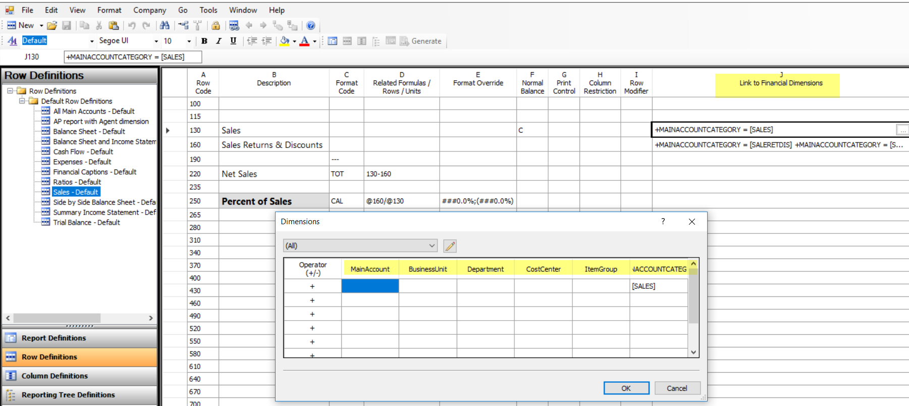

    Hi ALl,
    Currently, Management Report has only 5 financial dimensions.
    1. Business unit
    2. Cost Center
    3. Department
    4. Item group
    5. Main account.
    How do I add more financial dimension to the list?  Thanks
