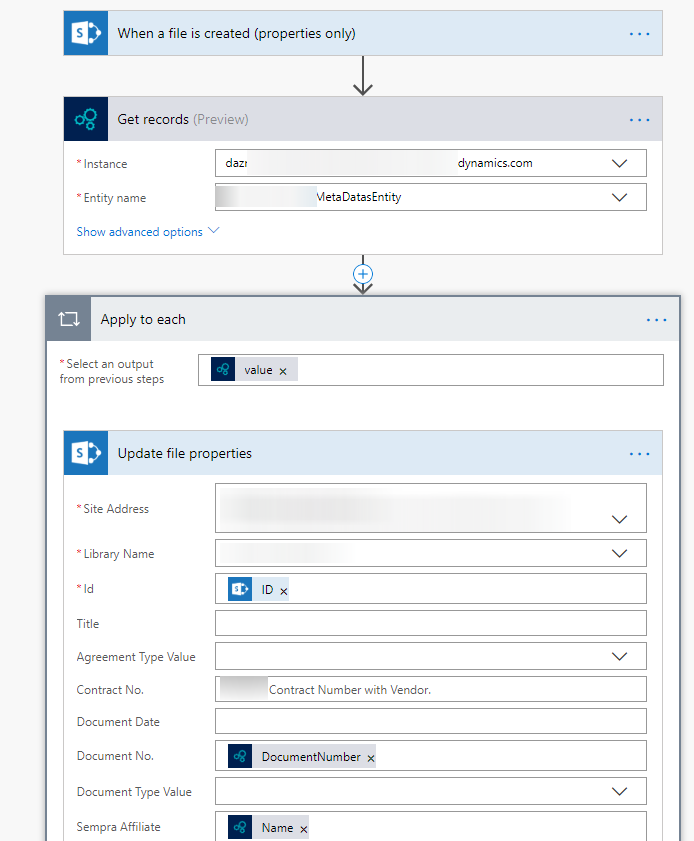

    I might be a little late to this discussion but we recently implemented a similar solution as well. This is what we did:
    1. Identified documents that use the attachment feature the most (PRs, POs and Purchase agreements)
    2. Create a single data entity that has the list of attachments with their related metadata
    3. Use Flow to update the metadata fields in the Sharepoint directory. (Each time a new file is loaded into the directory, a flow action is triggered which pulls data from the attachment data entity and uses the data in it to update the sharepoint metadata fields)

    Thanks for posting this, Suhas! I think you meant to put this in my other sharepoint discussion, but easy mistake! To be clear for others-- this was another discussion around how to write D365 record data to columns when using Sharepoint for D365 document management. This would allow non-D365 users to easily search attached documents using key fields (Journal number, SO#,PO#, etc) and browse in a more batch friendly manner.
    Speaking to your solution though, it seems pretty elegant since it requires little in the way of X++ dev. Question though, in the "Get Records" step, how do you query your metadata entity for the matching record? Document URL?
