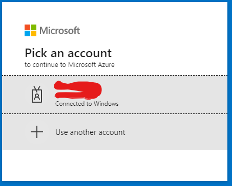

    I started having problems this week. When I tried to open D365, it would show that there were multiple errors but no indication of what the errors were. So I tried getting into Azure admin and it logged me in, but with another profile - my Office 365 profile or my Windows profile, I can't tell which. I logged out of Azure and cleared cache again. When I tried logging in to D365, I was asked to pick an account. Note how "Connected to Windows" appears for the first selection. I selected "Use another account" and was able to log in with my D365 profile. I've never seen the "Connected to Windows" before when being prompted to log in until this week. I Googled "Connected to Windows", but nothing I found worked.
    Update: Turns out it was the Single Signon setting in Edge Settings -> Profile -> Profile Preferences. It was turned on. I turned it off and the "Connected to windows" doesn't not appear any longer. Odd since I never turned on the single signon.
