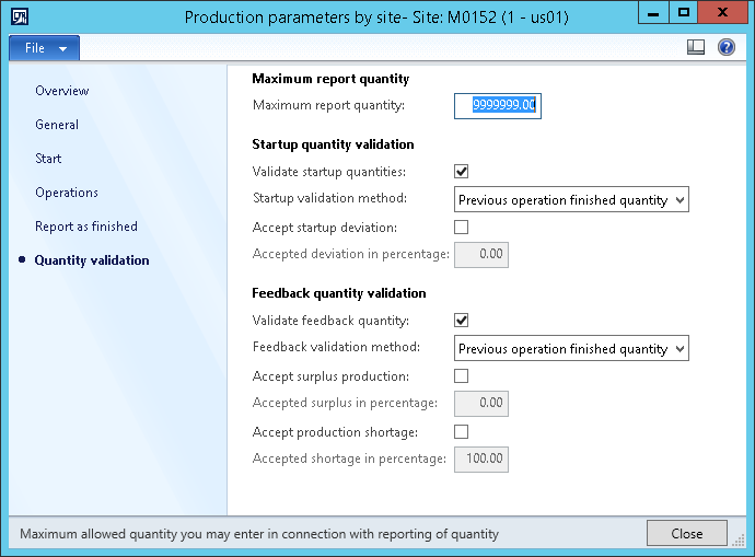

Thank you for the reply Andrew.
I wonder if I'm missing a setting, then, as I've tried just like you point out - but clocking to the first job of the work order gives an error
I tried the settings on Quantity Validation panel of Production Parameters By Site, as seen in picture below.
I created a new work order, scheduled and started it. When I tried clocking to its first operation, I receive the error "You cannot start a job with a start quantity of 0." I figured I must be doing something incorrectly.

When you say you tried the Quantity validation, did you set the Startup validation method to "Previous operation finished quantity"? This should prevent you from starting a quantity on an operation that was not completed on the previous one.
