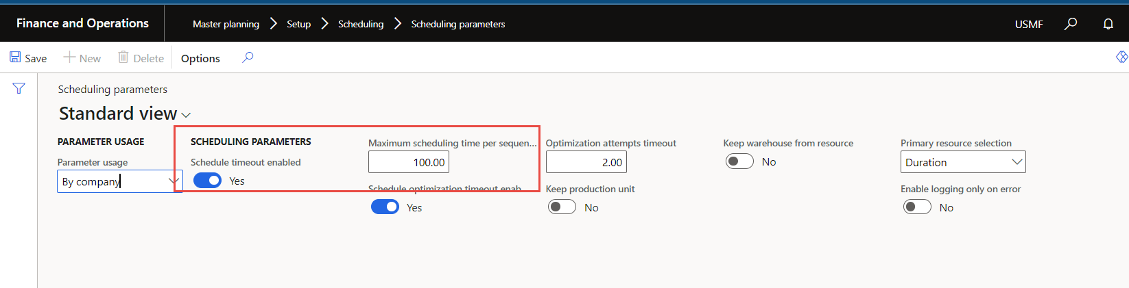

    Ho Joanne, this message basically means the scheduling engine still hasn't scheduled the order and it hit the timeout threshold and failed. You may need a sysadmin to update this parameter, but there' s a Scheduling timeout threshold that prevents MRP from running forever in scenarios that are complicated to schedule (i.e. bad routes, complicated and many calendars, complicated resource assignments with capabilities, etc.).
    If you are on D365, this setting can be changed from Master planning > Setup > Scheduling parameters
    If you uncheck the "Scheduling timeout enabled." button, you won't get that error, but MRP will run until it can resolve that scheduling conflict that is locking it.

    Hi Andrew, thank you for your response. Is there a similar setting in AX2012 R3... we are not on D365 yet. thanks.

    Hi Joanne, Yes the same settings exist in AX2012, they are just not located in the Master planning module. If I recall correctly, believe the Scheduling timeout parameter is under a Scheduling parameters section the System Admin or Org Admin module in AX2012.
