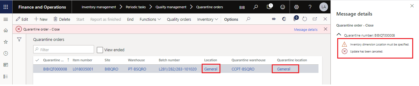

    Have you ever have seen this message while trying to end a quarantine order?
    It says I have to specify the location, but it's specified for both warehouses. This quarantine comes from a quality order for a purchase order. We need to finish the quarantine, could you please give me an idea of how could I solve this issue?

    I expect it is your receiving location that is missing. Try to make a registering and post it afterwards.
