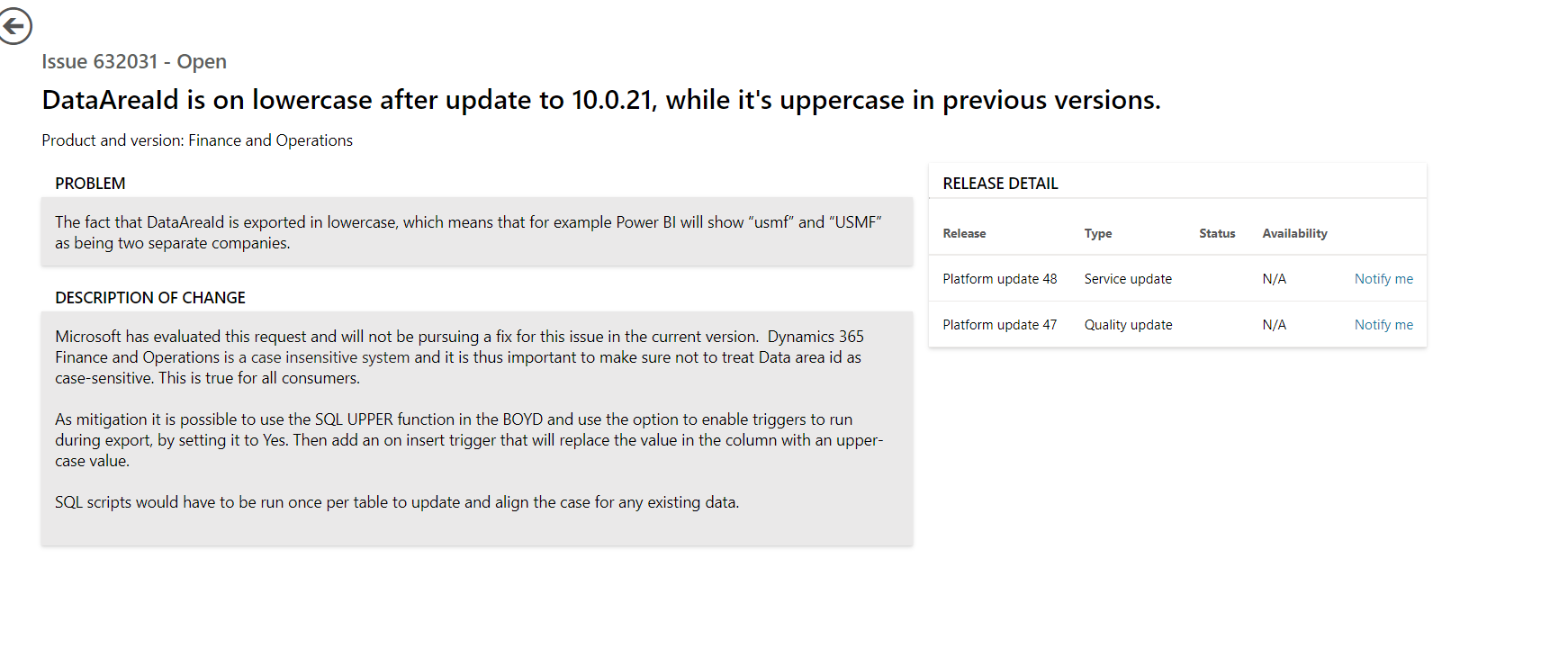

    Absolutely, just received an update from Microsoft as well as the issue - 632031.
    Placing triggers on the BYOD table by table is a pretty poor workaround.

    WOW !! that is not what I expected at all ...  We hadn't dealt with Microsoft 'yet' as we were looking at changing our BYOD to Synapse in a few months and we already had a quick fix in place using our current ETL process. I was thinking (hoping?) the feed from D365 to Synapse would address it, but now I don't think it will.
    I wonder what other ID fields can or will change text cases or is this just specific to DataAreaID?
    I thought about using triggers in our current SQL db, but that just seemed like a poor way of dealing with it, extra processing during staging. It would also mean playing around with our incremental data export jobs which we **finally** have running without errors.
