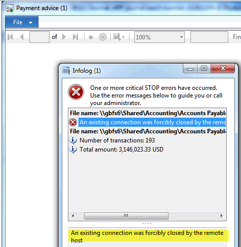

    ​Our AP users are receiving this error when processing EFT payments to vendors.  We believe it might be a report timeout issue because it comes up after about 10 minutes.
              Error msg during EFT payment processing
    They do not receive this error on smaller payment batches.  I suggested that they make several smaller batches, but they would rather not do that because it creates a lot more manual work in order to pick and choose which transactions go into each batch.
    Does anyone know the SSRS report and associated class(es) that would be involved with this process?  I'm having difficulty determining these objects.
    Also, we've had trouble increasing the timeout parameter of SSRS reports, whether we try it on individual reports on the report server, or through SQL Server.  No matter where we try to make the change, it has no effect, even after restarting the AOSs and report server, and the reports still timeout after about 10 minutes even though we specified 60 minutes for the timeout parameter.  What is the trick for making this change "stick"?

    ​Paul, thanks for the info.  The report is actually a standard SSRS report in AX that lists all the payment info for each vendor for EFT payments that are being processed.  I'm not aware that this specific report had to be customized for our purposes.
    You mentioned that you "cleared the query plan and fixed the query".  How exactly did you do that?
    We're thinking that maybe we need to run the process through Trace Parser and SQL Server Database Engine Tuning Advisor to see if we need to create an index or two to speed up the process.

    ​I ended up running the process through Trace Parser and SQL Server Database Engine Tuning Advisor, and created several recommended indexes and statistics that were supposed to help improve performance.  Our AP manager received the error again when she ran the process, but this time she got the error after only 3 or 4 minutes.  So we no longer think it's a timing-out issue because the error came up long before the 10-minute mark was reached (our reports time-out after 10 minutes).
    We're not sure what else to try, so right before they run the process again we're going to delete the AP user's .auc files from their C:\Users\userId\AppData\Local\ folders, as well as clear their Class usage data.  We really don't think it will help though because they're able to run the process w/o error on small payment batches.
    Does anyone else have any other suggestions?
