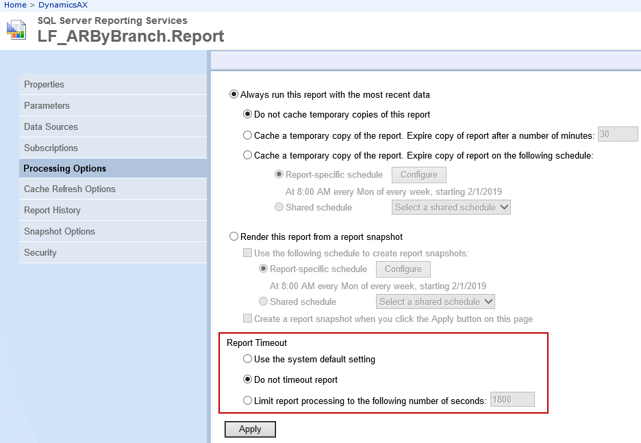

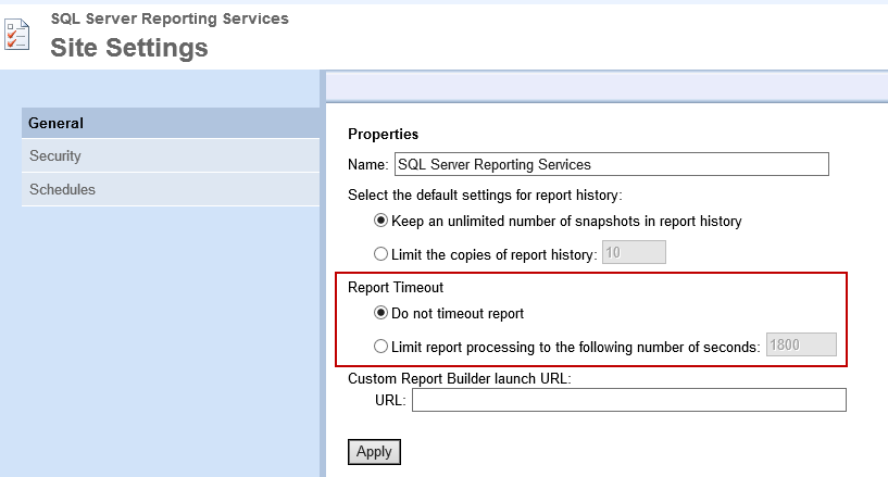

    ​Over a year ago we tried changing our Report Server settings so that reports would run to completion instead of timing out after 10 minutes.  Despite making those changes, reports would still timeout after 10 minutes.  To get around that problem, I ended up changing the specific reports to run in "pre-process mode" by changing the data provider class to specify that it extends the SrsReportDataProviderPreProcess class.
    Due to monthend, today we have an urgent situation where a much-needed report is timing out, and we're unable to make the necessary pre-process changes without having to do a code release to our PRD environment.  Currently I have the Report Server Site Settings and the report's Processing Options set to "Do not timeout report".
    Report processing options
    The report still times out after 10 minutes.
    Any other quick suggestions for allowing this report to complete without timing out?
