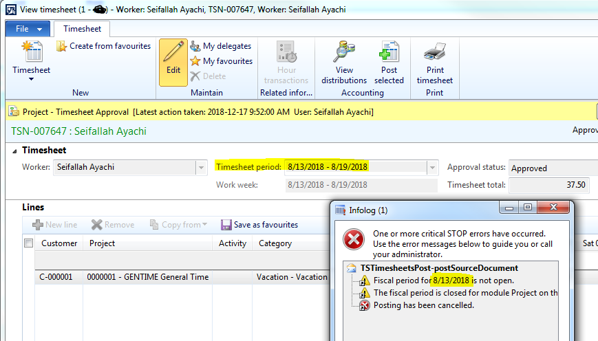

    After applying the last CU13, we noticed that the feature "Allow date corrections on timesheets" is not working anymore
    1- Option is enabled under: Project management and accounting / Area page / Project Management and Accounting Parameters / Timesheets

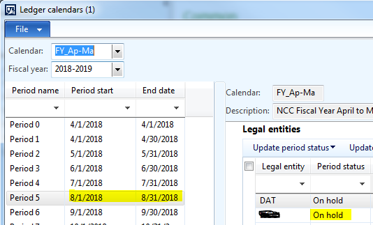

    2- Ledger Period for August is closed and open for September (i'm posting time in August for this test)

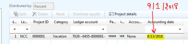

    3- When submitting the Timesheet in August, the system is supposed to set the accounting date in the next "Open" period which is september but it's not. and now the Timesheet can't be posted...
    The distribution date is supposed to be 9/1/2018... as you can see it's not changing.
    did anyone face this issue ? i'm i missing a setting or a KB (i couldn't find any relevant info in LCS)

    I have just used this setting successfully, with a timesheet for transactions in December, which posted with a date of 01/01/2020.
    However the December period was only on hold and not closed?
