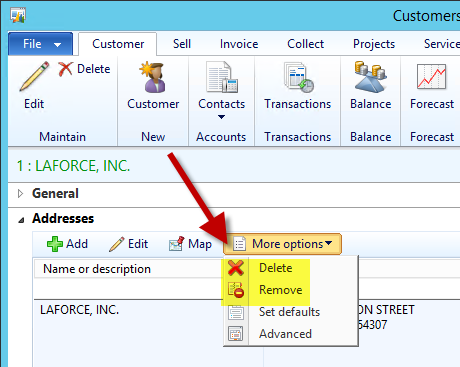

    ​Our sales manager wants the sales staff to have the ability to Delete or Remove old unused addresses from the customer master record when necessary.
    Delete and Remove Customer addresses
    Which security privilege will give them the ability to do this?

    Hi Rudy,
    The delete action is controlled by a menu item action called: 'CustDirPartyPostalAddressDelete'. Out of the box, there is no privilege having this menu item included. So, to have this option available for non admin users, it needs to be included as privilege, duty and then linked to a role.
    The remove option is controlled by the duty 'Maintain global address book master' (DirAddressBookMasterMaintain). This is included on the roles 'Human resource manager', 'Logistics manager' and  'Information technology manager'.
