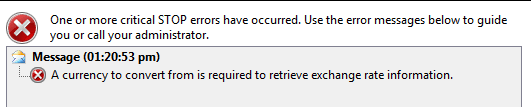

    ​An AP user is getting this error msg that we haven't seen before when trying to post an invoice:
         Error msg when posting AP invoice
    Any suggestions for resolving this error?

    My company was sporadically receiving this error also. We are using AX 2012 R3 CU13.
    We traced it to a Microsoft code bug in the method calcHistoryInvoiceAmount of the PurchTableDocument class:
    In the outlined code block - the red highlighted line is causing the issue because the purchLine.CurrencyCode will always be blank(null) due to the select statement preceding the line.

    ​Richard, thanks for your solution.  We'll look into implementing it in order to avoid the error in the future.
    In the meantime, our Controller sent us this message regarding the error:
    "I couldn't get past this error but I think I was able to make our problem go away.  I manually added some on-hand quantities to the serial numbers to be able to reverse the PO receipt to get the PO back to an open order status. I tried re-receiving the lines and invoicing through but got the same error, so I reversed everything back to open again. The job is billed and paid complete and dropped from the system, so I can't create another PO/SO for the job, but what I can do is reclassify the journal entries that were created when I reversed the receipts list to the account we were trying to put them in to start."
    So for the invoice that received the error, it's no longer an issue.  But now that we know the code that probably caused the error, we'll want to take steps to avoid the error in the future by modifying the code as shown above.  Thanks everyone!
