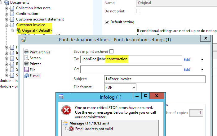

    We need to manually update a customer's invoice email address because it ends in ".construction" (which is valid), and the UI is throwing an error when the user tries to enter it because the RegEx only allows for 9 characters at the end of the email address.  We can change the RegEx so it will allow the entire word "construction", but due to a big project we won't have a code release for at least 2 months.  In the meantime we need to manually update the customer's invoice email address via SQL.  Any idea which table stores that info?

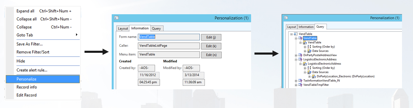

    I'm not sure how to navigate to that page within AX but can you right click on the email field and go to Personalize? This will show you the information where this data is being pulled from.
    My guess would be in either the DirPartyTable or the LogisticsElectronicAddress tables as this is where email information is normally stored.

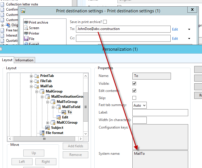

    @Alex Meyer  Before I tried tracing the origin of the email address thru code, I looked for the current "To" email address in the LogisticsElectronicAddress table but couldn't find it.  And unfortunately there aren't any email addresses stored in the DirPartyTable.  Personalizing the SRSPrintDestinationSettingsForm shows that "MailTo" is the form control name for the "To" email addr.
    Unfortunately I'm having trouble tracing it back thru the code to determine the table that contains the value that populates that field.

    @Mara Taylor  Thanks for your input.  The real issue is that the AX 2012 R2 UI for print destination settings is throwing the "Email address not valid error" because the RegEx used to validate the format of the email address is not allowing email addresses that end in ".construction" because that's greater than the 9 characters that the RegEx currently allows.  The user gets the error when trying to enter the new email addr ending in ".construction".  So we were hoping to manually update the email addr via SQL, but are having trouble determining the table where the current email addr is stored.​​
