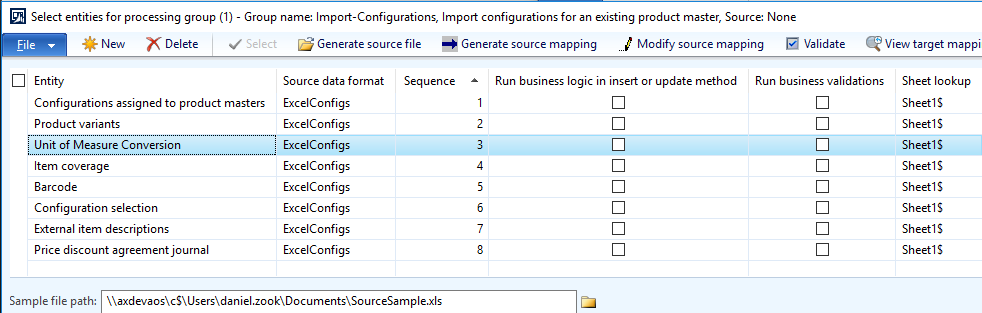

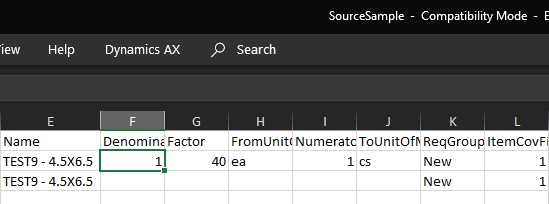

    I have a processing group that is designed to import from a single spreadsheet tab into multiple entities.  This processing group works just fine as long as every single column in the source spreadsheet has a value in every column for every row that has any data in it.  If any record has a column that is blank, the corresponding data entity that has a field mapped to that column will fail *all* records, even ones that do have a value.
    Here is a sample infolog that might help clarify what is happening.  In this scenario, there are two records in the spreadsheet.  One record has a value in every column, and the other has no value in the columns that are mapped to the Unit of Measure Conversion entity.

    My question is why the  DMF is failing to import *all* records into the staging table for the Unit of Measure Conversion, when it should have been able to import one record (the one that has values)?

    By default "ignore error" is disabled, so I tried it with it enabled and it worked like I needed it to… the records with data were imported into the entity staging table, and the blank rows threw a warning.  The key is that the blank rows didn't prevent the other rows from going into stage.
