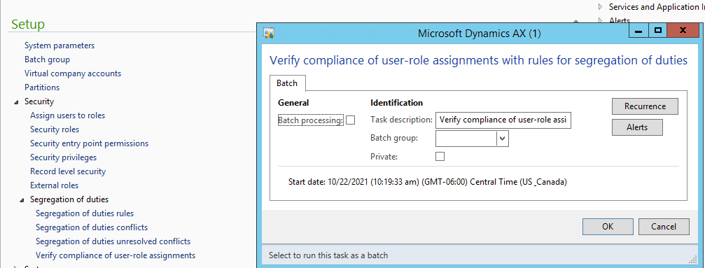

Mark,
1) To validate all SOD rules at once you can run the 'Verify compliance of user-role assignments with rules for segregation of duties' process located at System Administration -> Setup -> Segregation of duties -> Verify compliance of user-role assignments. This runs as a batch job and will output the results to the Segregation of duties unresolved conflicts area located in the same module.

Because of the way that security was set up prior to my arrival, one AX function may exist in three different duties that we want to segregate from another function that exists in five duties. So I am having to set up 15 different rules to address what should have been only two duties and one rule, had it been set up in a more logical fashion. I don't have time at the moment to unwind all of that yet.
- Is there a way to validate all SoD rules at once to find conflicts between roles? The Microsoft docs above that I read seem to point to having to click on each rule, one at a time, to run the duties and roles validation.
- Is there a way to set this up once in a lower environment and move it to the higher environments without having to re-key the rules from scratch?
