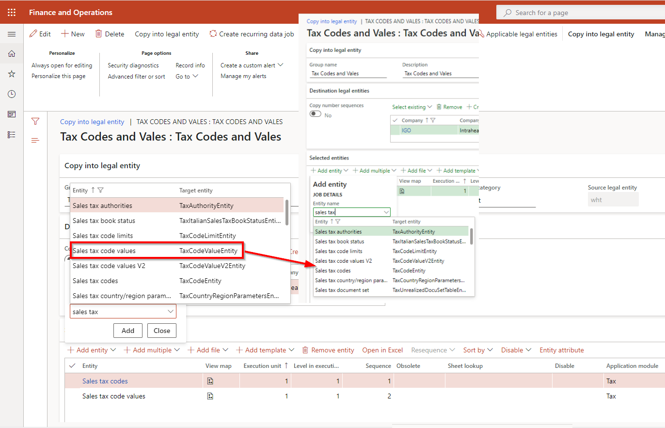

    I have found that the Sales tax values data entity appears to be missing from the list of any users that DO NOT HAVE the system administration role. The user does have the other Data Management roles typically associated with DMF access.
    The orange session is the system administrator's view. The green session shows that the data entity is unavailable. This user has the Data Management roles.
    It's unusual that the Sales tax code values V2 is available, yet the original one is not.
    Does anyone know how to make this available for users other than System administrators?

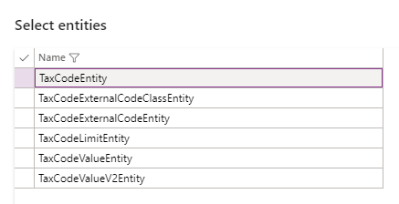

    You can create a new privilege/duty/role and assign Entities to the privilege directly. The privilege can then be added to the role the user has in addition to the DMF role. The tax code values entity is available for assignment, and this is how a user would get access through DMF as well:
    We have a number of users that can do things through the interface, but sometimes the entities aren't exposed to the users and need to be added this way so they can use DMF to load data into the entities directly.
