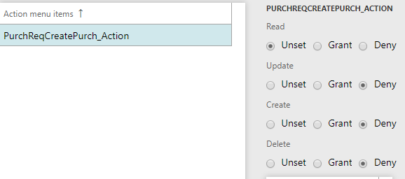

  • 5.  RE: Purchase Requisition Questions
    Posted Jul 08, 2019 07:43 AM
    I just did some testing myself, seems a little more complicated, but doable:
    - Create an employee/worker record for the user and link to the user record
    - Provide privilege "maintain all purchase requisitions" to the user
    - Create new privilege that has a Action menu items "PurchReqCreatePurch_Action" set to Deny for update, create, and delete and assign to user
    I have tested this and I can view all purchase reqisitions but not create or update anything on the purchase requisition screen - however I was able to delete or add new attachments, I am not sure if that is something you would want to restrict as well? If so, I am not sure how to do that as it seems to be a general "document handling" privilege that might not just apply to attachments on this screen but all document attachments in the whole system.

  • 7.  RE: Purchase Requisition Questions
    Posted Jul 08, 2019 01:38 PM
    I tested this out, and worked perfectly. Thanks for all of your help with this! Have a great day!!
