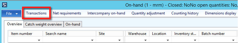

    When we have detected negative work quantities, usually is because a user made a manual inventory movement, or an inventory adjustment at the location. Have you ckecked the transactions associated to the item and location on Inventory Management -> Inquiries -> On Hand.
    On-hand transactions
    Hope it helps to find out what is going on.
