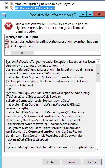

    Hello everyone. We are using DAX2012R3 CU10.
    I've followed the steps to install DynamicsPerf 2.10 on premise as a remote deployment, but when I try to execute step 2, to configure an schedule AOT metadata capture within AX opening the class AOTExport2012_Direct, I receive the following message:
    AOTExport2012_Direct error
    Has anyone experienced this error and how have you solved it?
    Thank you.​​

    Hi Mario,
    Usually, this can be caused by a typo or wrong credentials. Using DynamicsPerf, I have not seen this error.

    Mario,
    I agree with Andre, this error is probably from some sort of connection parameter misconfiguration or authentication issue. The error can be generated from a number of different things, luckily Microsoft has documentation surrounding this exact error:
    https://support.microsoft.com/en-us/help/811889/how-to-troubleshoot-the-cannot-generate-sspi-context-error-message
