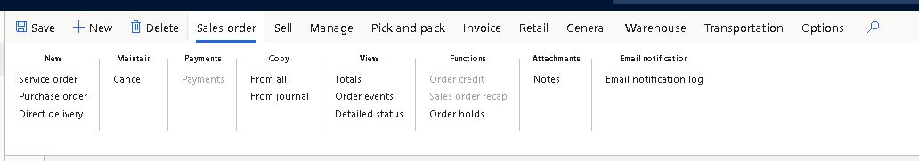

    In the demo environment I need to try out the call center sales order features as part of the fit/gap analysis.  Unfortunately, the "complete" button is missing, and the payments and sales order recap buttons are disabled.

    Microsoft suggested using USRT (instead of USMF, which is the company I was using), and that works.  Just FYI for anyone else in this predicament.
    Apparently the reason for this is because the call centers list is company-wide, but each call center is linked to a particular company.  I missed that...  :-/
