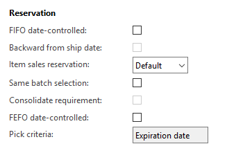

    Reserving by expiry date is controlled by using FEFO reservation logic, which is defined in the Item Model Group applied to the item.
     If you enable this, your items will need to have Shelf life period in days / Best before period in days defined on the released product

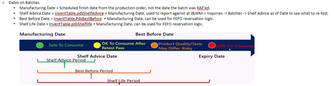

    Here's definitions of all the dates on a batch when you use FEFO:
