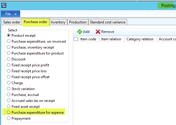

    Hi All
    I am setting up Procurement and sourcing for multiple company in same instance. Is there a way to upload Posting profile using ATLAS or DIEF or Script  under instead of copying and pasting over 300 lines
    Inventory Management -> Set up -> Posting -> Posting -> Purchase order - Purchase expenditure for expense

    Hi Nazim,
    In AX2012 I don't believe Microsoft have released an entity to cover off the Inventory postings (SalesOrder,PurchaserOrder,Inventory). However if you have atlas you can set up an upload template to do this for you (Note: It would be worth checking GlobalSoftware support site as they may have a template configured already)
    If not the AX table you need to populate is "InventPosting".
    For the main account you will need to reference the RecId in that table so you may have to get the data from the DimensionAttributeValueCombination table.  Relationship: InventPosting.LedgerDimension== DimensionAttributeValueCombination.RecId.
    Atlas should already have this relationship configured on the table as it is a defined relationship in the AOT so you should be able to add the "DisplayValue" field to the template without too much trouble.
