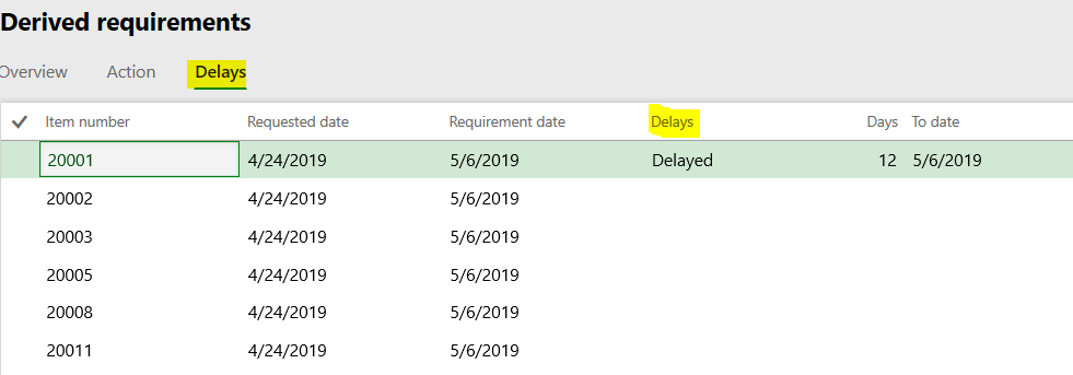

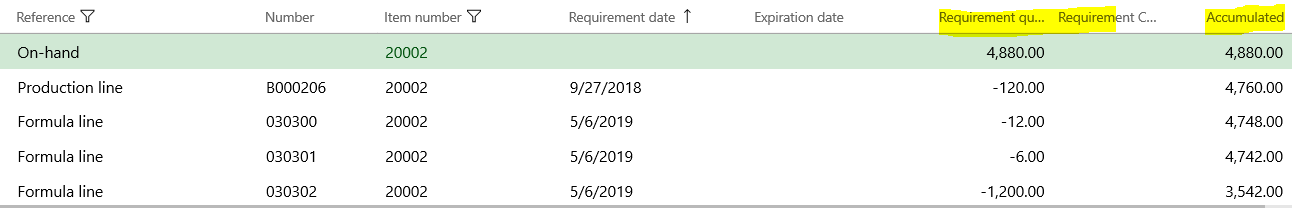

    There are normally a couple of reasons to see a delay. To troubleshoot I run a net requirement on the item from   Release item > Plan > Net requirements.  This will show me my requirements and more importantly my accumulated totals in a time fence. The second step is once I find the line in question, in your case, the Transfer line and the Accumulated value is positive I drill in on the Number to get to the Derived requirements. I then select he Delay action tab and review the results, because it can be an upper level demand driving the delay. MRP is always trying to time all actions (purchase, transfer, production) based on the highest level requirement.
    Net requirement
    Deived requirements
    Delays
