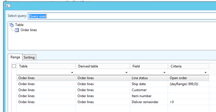

  • 5.  RE: Batch job autoreports (auto reports)
    Posted Nov 26, 2018 03:52 PM
    Hi Brad,
      If by auto report you mean the File -> Print -> Print -> Autoreport, Corey is correct, that can't be scheduled in batch.
    If the backorder sales lines grid is one you specifically need to replicate, you can get the same row set but maybe different columns, in R3 by running the report at Sales & Marketing -> Reports -> ​Sales orders -> Open Sales order lines by Customer / Item / Ship date and using an advanced filter like this, then you can schedule this to run in batch and print to email.
    Hope that helps, its not going to work for stuff where there isn't a similar SSRS report though.
