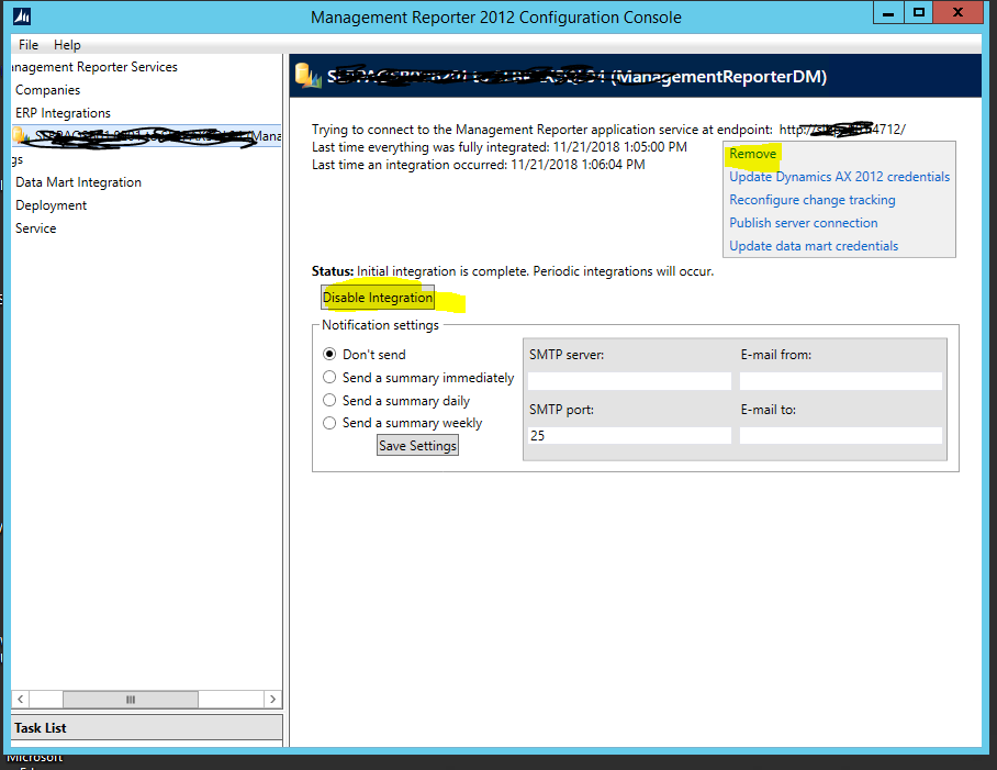

    Hi Kevin, when you know your going to refresh a AX Test environment that has MR setup you should disable the integration in the Configuration Console and stop the MR Services, do the refresh, come back into the configuration console, remove the existing DataMart, and add it back (File ->Configure).
    I might note your MR Reports are safe because they are stored in the Management Reporter database.   If you need to update those you would export out the building blocks and import them into test which may need to happen from time to time.  This is done through the MR Report Designer.
    MR Configuration
