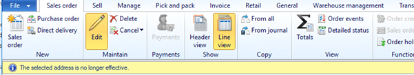

    Good day,
    Kindly advise if there is a report within AX that details open sales orders with an address that is no longer effective.
    What we would like to provide, is a report that can easily be generated to check which sales orders need to be corrected with the below error message.
    The preference is that this report not be extracted from the AOT.
    Any input would be greatly appreciated.
