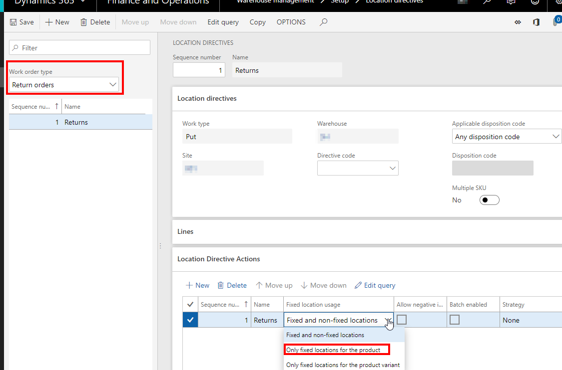

    Has anyone ever set up work templates and location directives for back office sales returns so that the items that are being returned by a customer are directed to be put away in the products fixed locations?

    Hi Jeff,
    Yes this is actually pretty common. There is a specific Work template and Location directive for Work type "Return orders" that should be used for this. As far as the Mobile menu, you have Return order receiving and Return order receiving and putaway, similar to other receipt transactions.In your location directives, you would have the Location Directive Action set to look for Fixed locations:
    Is there a particular issue you are having with this configuration?
