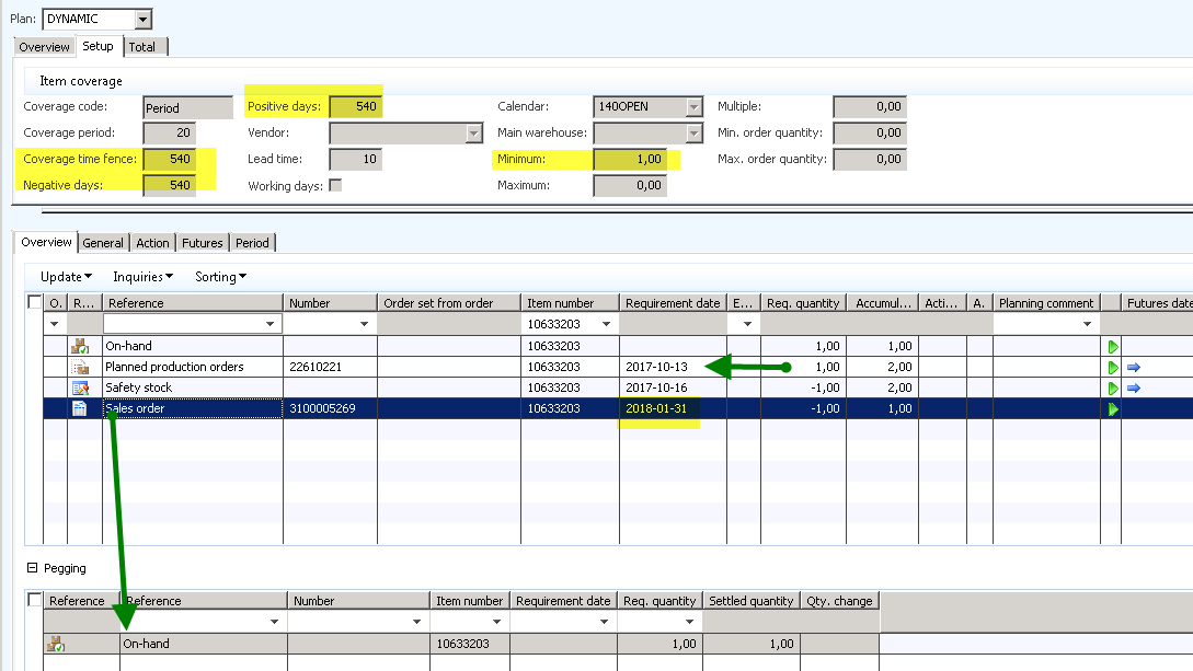

    In a copy of production data in an environment running on CU12
    1. A sales order is placed in 31st of January in 2018.
    2. After Master scheduling update
      • planned planned production order to refill Safety stock Todays date + replenisment lead time 10 days. 2017-10-13. (Requirement date Safety Stock 2017-10-13 + 1 day for receipt margin + weekend). The planned order is Pegging against Safety stock
      • Sales order Pegging against On Hand
    Question is - why refill already now?
    • Same scenario occurs if there is demand forecast entered instead of a sales order.
    • This happened after CU12. We had other envrionment running on CU11 before and did not have this problem.
    • I can reproduce same scenario in our Contoso that is running on CU12
    • My guess it is related to the KB3190607 in CU12 named "Safety stock is pegging inventory to itself, causing other demand types to delay". I have no more detailed information about what does this KB actually fix.
    • Impact if we switch to CU12 in our Production environment there will be planned orders to replenish our stock to early. Over production and our planners will not be happy when they cannot trust the suggestions after master scheduling.

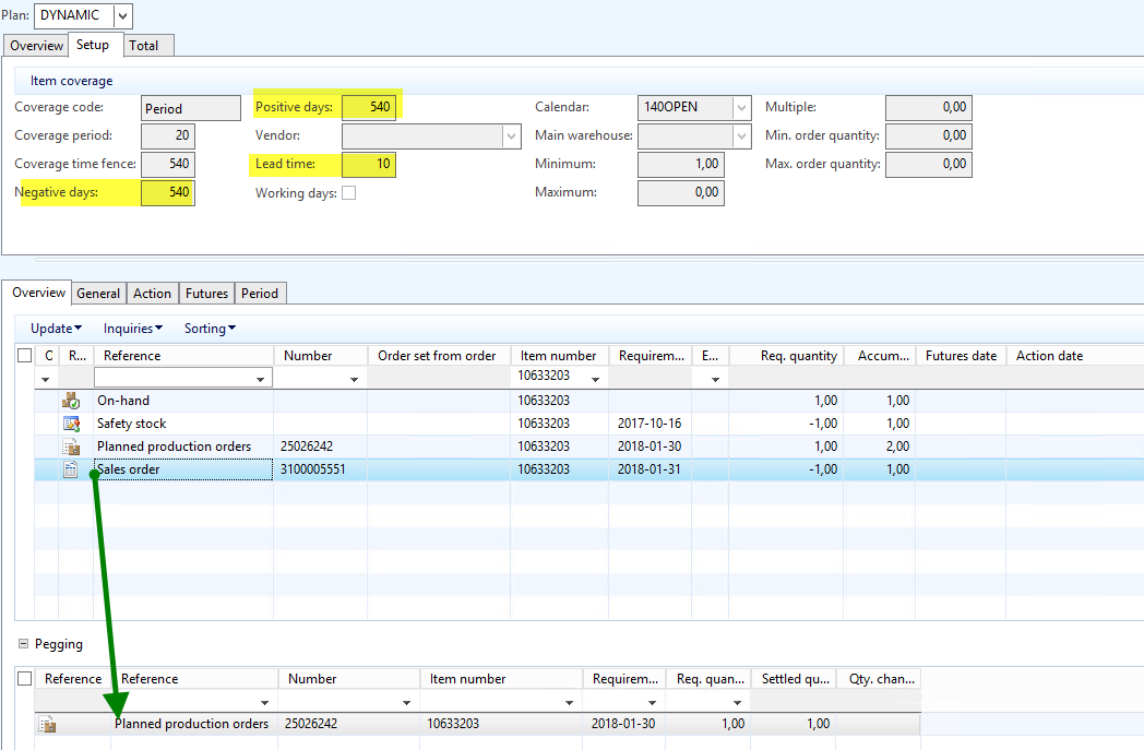

    Compare with copy of our existing production data in an environment running in on CU10.
    2. After Master scheduling update a planned planned production order to meet the Sales order demand in January
    Item coverage settings for the item except for the set up tab in net requirement pictures above:  Fulfill minimum: "Today´s date + procurement time

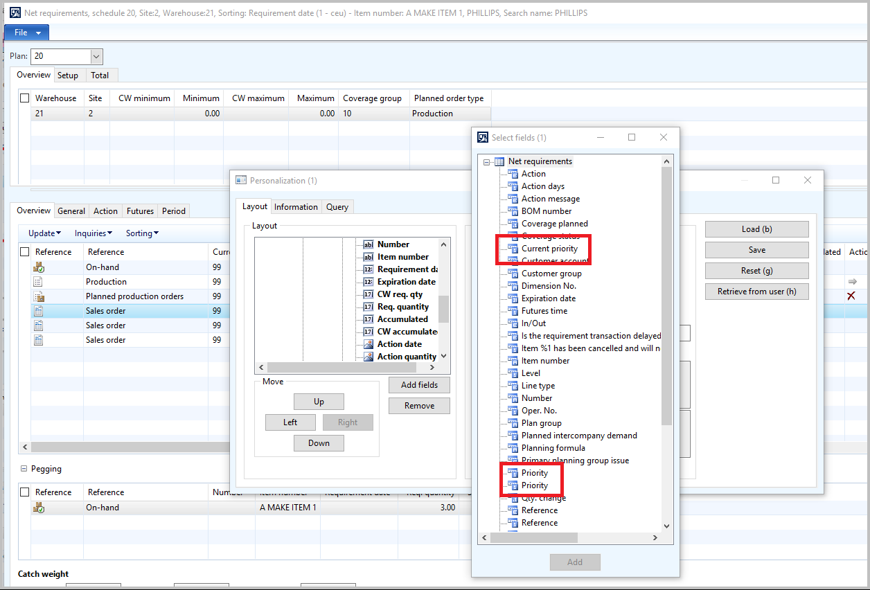

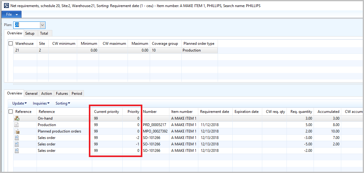

    I don't know your setup, but the next thing I would do is a slight Personalization to the Net Requirements form that provides an indicator of a Reservation in play.
    PHILLIPS-01Use the first Priority.
    PHILLIPS-02Reservations have a negative number. Prior Reservations can impact Pegging.
    Check your Consume On-hand Inventory setting (Master Plan and Coverage Groups).
    Then, in a Test environment, I would start troubleshooting. Do you use Shelf-Life? Turn it off and test. Next I would turn off Action and Futures (turn off in the MRP Plan | Time Fences form). I also often take the Route out of play by turning off Capacity (same way as Action/Futures).
