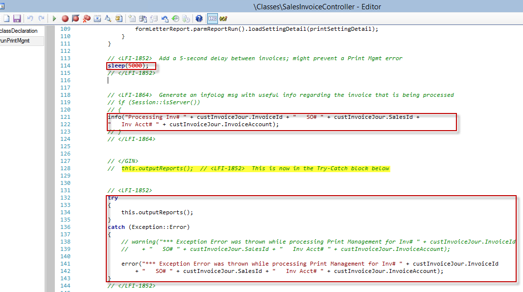

    Rich, in case it helps, here's a snippet of some code that I added to the runPrintMgmt method of the SalesInvoiceController class.
    The 5-second delay didn't actually resolve the emailing issue I mentioned previously, so I'll eventually remove it.
    The info message was added because AR had no way to determine which invoice was printed or emailed.  We're on AX 2012 R2 CU7, and the invoicing infolog previously only indicated that an invoice was either successfully printed or emailed.
    I put the this.outputReports() statement in a Try-Catch block to prevent the batch job from erroring-out when an error was encountered during printing or emailing.

    We are going to try the sleep, but start low.  We are thinking even a 1/2 a second would help in our instance.  Something worth trying, and then move on from there.  We are not excited about prolonging our invoice process.  We typically would like to have all invoicing done by end of business day, rather than overnight invoicing, or going past 5 PM EST.  I'll be able to run a test today, in our TEST systems, for 230+ orders.
    The other code snippets you have are great!  We currently just match whats in some created filters in our Sales Order screens, and go off a few reports for "Order Lines Not Invoice" so we have a great system now after the batch runs to "double-check" our work.  We'll keep the info write line you created in mind, if we want that on our daily report, that we create from the info log.
    We haven't' gotten any errors (yet) on printing of emailing through PM, but the try-catch makes a lot of sense.
