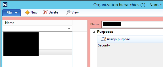

    I first setup an Org Hierarchy for Security.

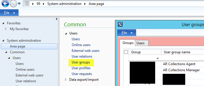

    Then setup User Groups per Role and Org Hierarchy/Company combinations.

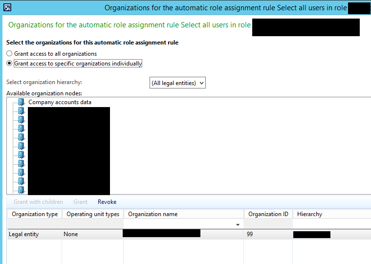

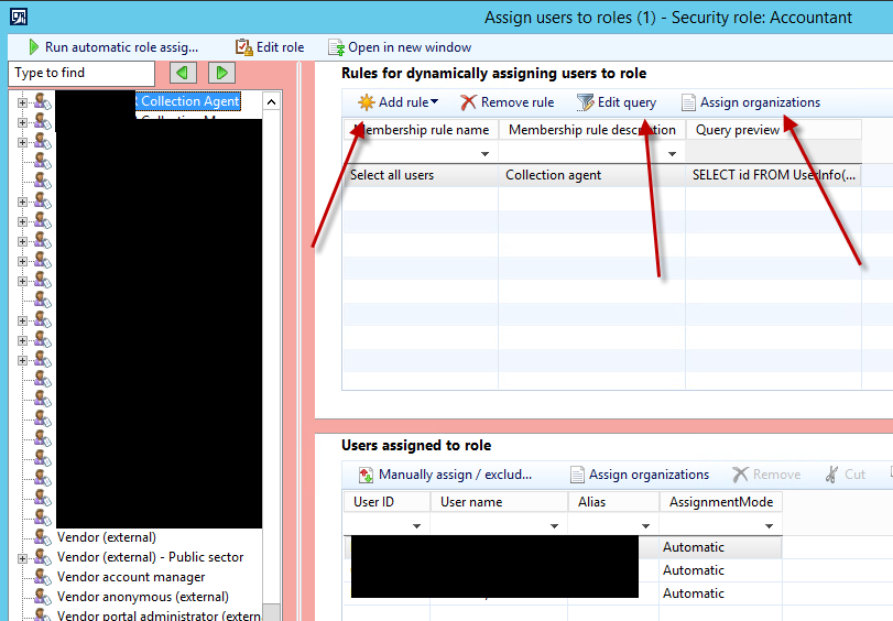

    Next, under Assign Users to Roles, I added a rule with a query based on user groups. (Note: Assignment Mode for users in this role is Automatic)
    IkRwuQ6HSnSbnvetJhaD_Role Rule.pngEpvL2sq2STS7demzPrDq_Assign Heir - Rule.png

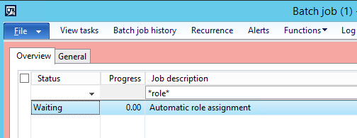

    Finally, I setup a Batch Job to run the automatic role assignment.

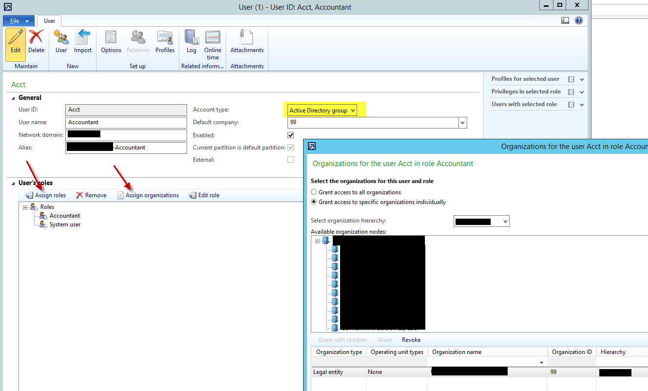

    I am exploring a shift from the above to an Active Directory Group concept. With this, I will create AD groups, AX Users with Account Type = Active Directory Group, assign the role, and assign the org hierarchy for each role and organization combo I need. This would eliminate the need to use User Groups, rules, and automatic assignments. AX security is now as simple as maintaining AD groups!

  • 8.  RE: Script to limit users access to one company
    Posted Apr 03, 2019 03:17 AM
    Hi Anbu,
    If you have multiple legal entities and you want to create rules for giving access to a certain legal entity, you can actually follow the procedure as described above and create multiple rules for the same security role.
