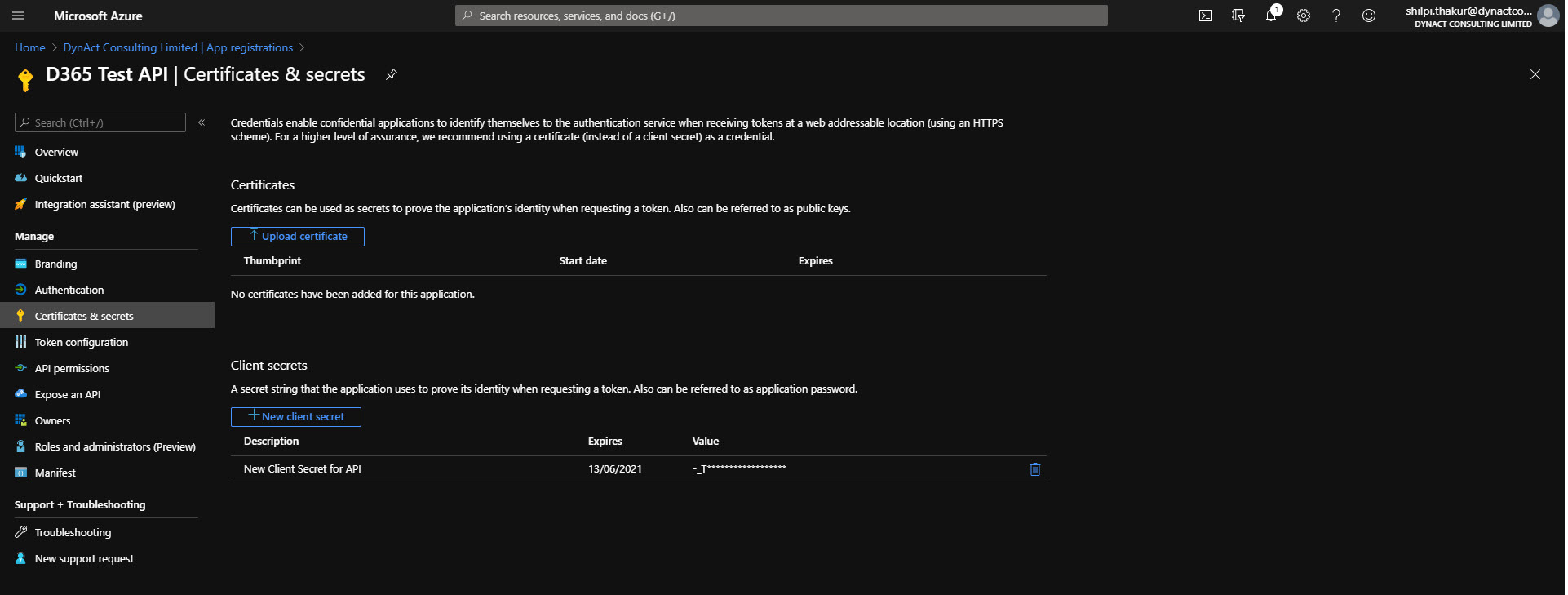

Step 2: The next step is creating a secret key in the Azure Active Directory for the registered App. Click on Certificates and secrets and then under Client secrets create a new secret key.
Save and note down the value of the secret key. Once this page is closed, you cannot see this value again.

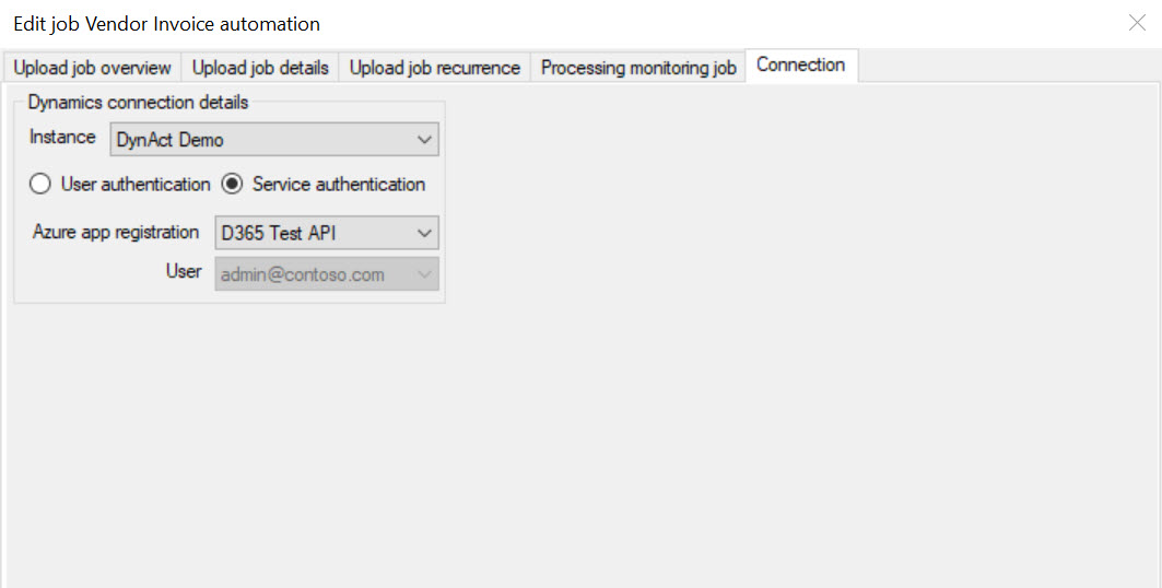

Step 2: Next, Validate the settings by selecting the Dynamics 365 instance, and then click Validate image, selecting the Service authentication option along with the AAD client App of the service.

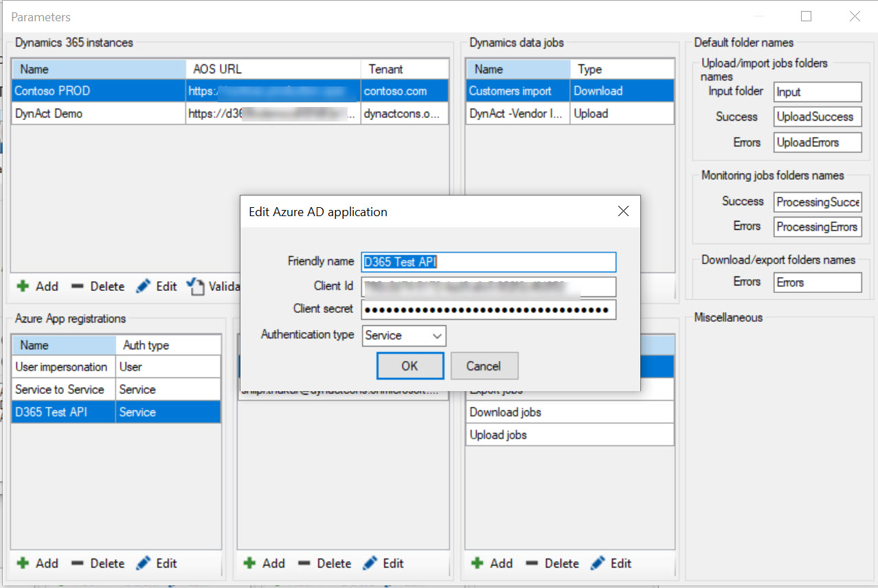

  Next, click on the Add in the Azure AD applications section.
Enter the following:
  • Friendly name
  • Client ID
  • Client secret [The secret key generated in registered Azure application - Section 1.3 - Step 2]
  •  Authentication type - Service

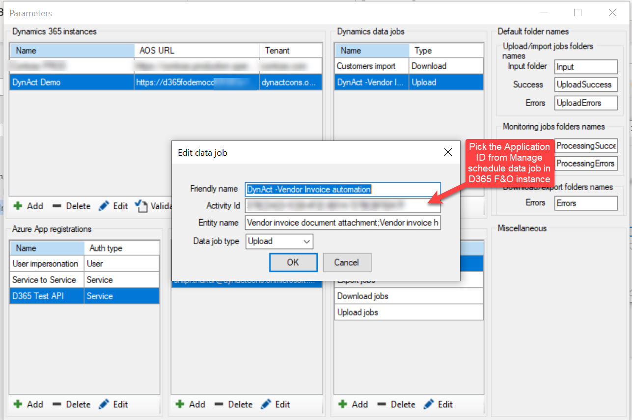

Step 4: Next, set up the Data job by selecting 'Add' and then entering the friendly name with the Activity ID, which can is available on the Manage schedule data job in the D365 F&O instance.

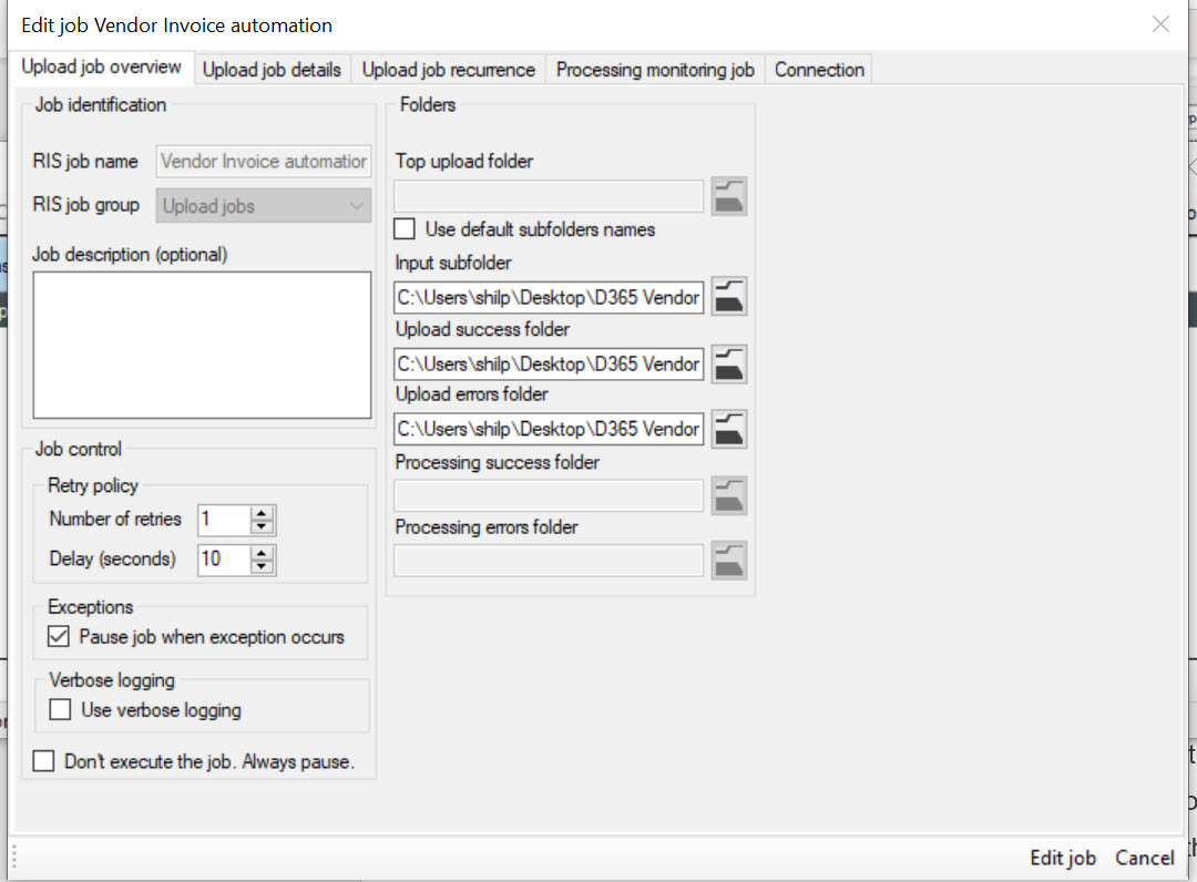

Step 5: Create the upload or import job details and connection setup and save the setup.
Step 6: The final step is to drop the import file into the Input directory, and it will automatically get processed at the scheduled time and moved into the UploadSuccess folder.

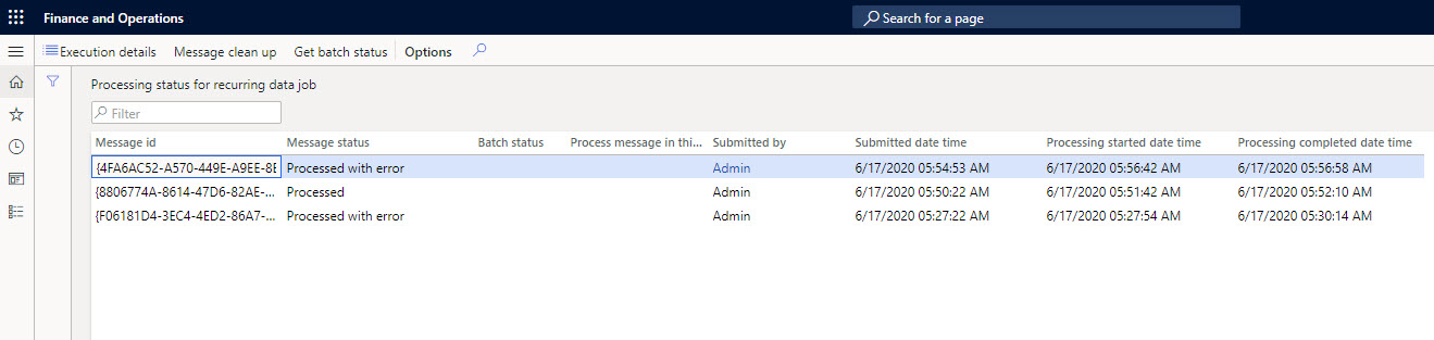

2. Monitoring Messages in D365 F&O
In D365F&O, when I go to the recurring job and click on Manage messages in the ribbon, I can see the messages put on the queue by the flow. In the following screenshot you can see that at the top of the list, I have a queued message ready for processing after I invoked the scheduler.

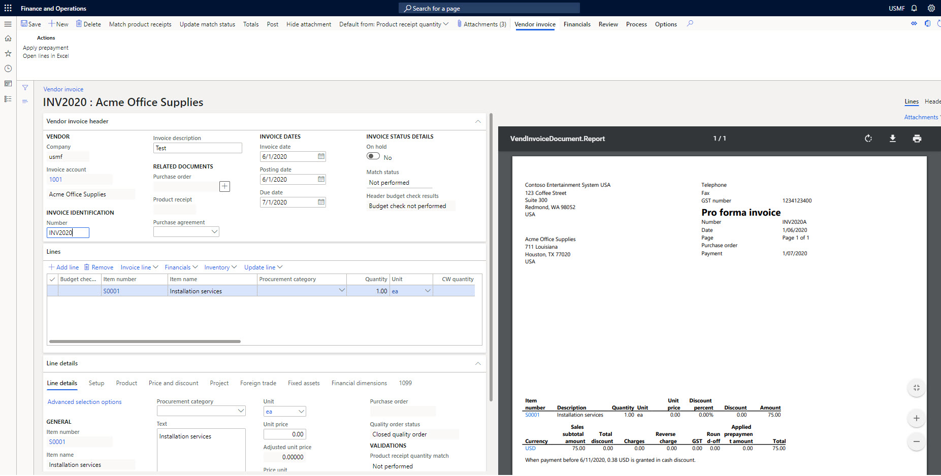

Go into the Pending vendor invoices screen form and open the automated created.
Open the pending vendor invoice to see the header, line details, and side by side view of the vendor invoice attachment.
