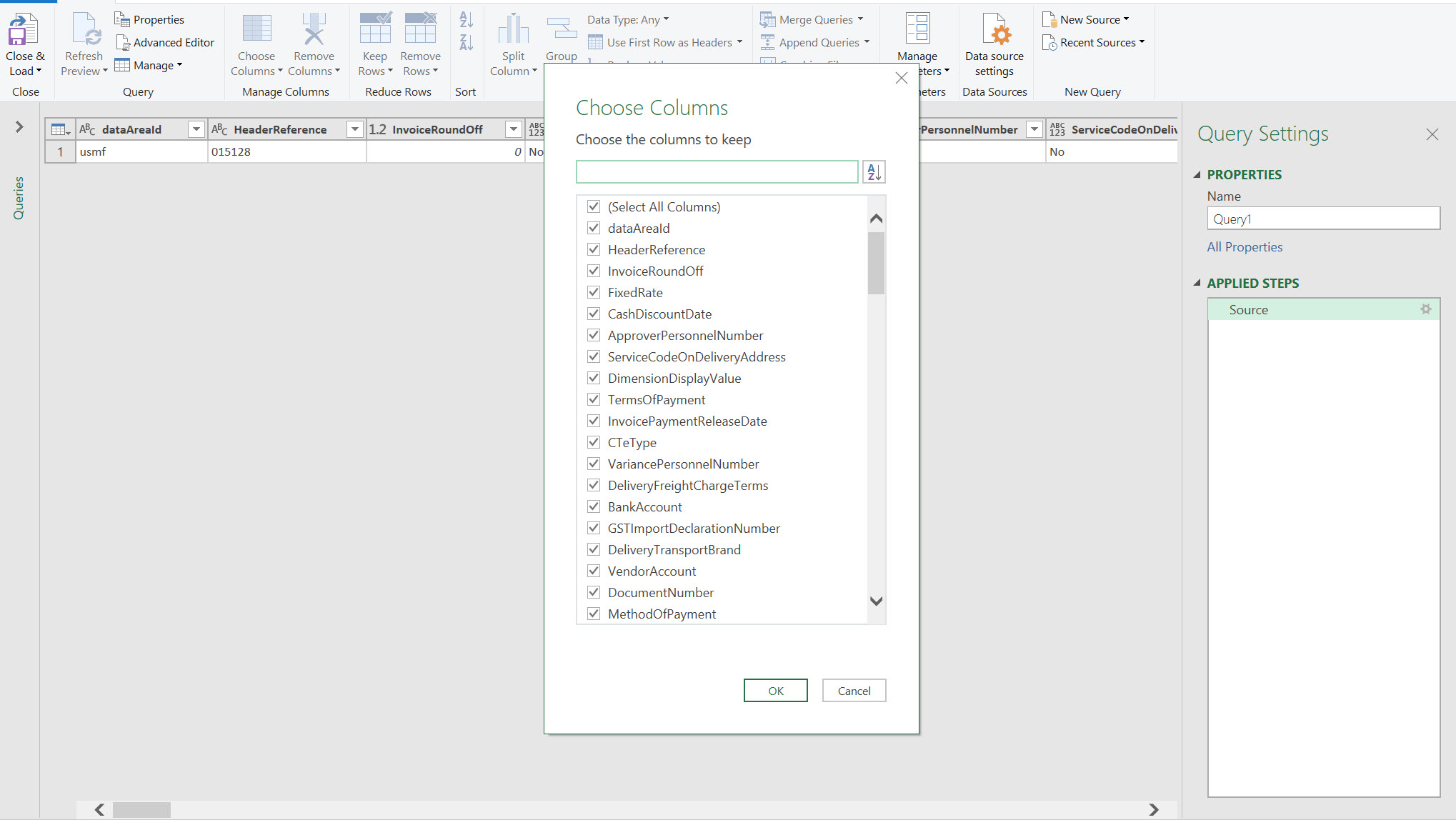

4.2.1 Consuming the OData source with Excel
Sign in with your AAD credentials, and you can expose the data entities via OData into excel through the OData feed.
 After you click on Connect, you will get a popup where you can choose which tables you want to import into Excel.
Required fields:
  •  HeaderReference
  • Currency
  • Date
  • InvoiceAccount
  • InvoiceId
  • InvoiceNumber
  • IsApproved (Set to No)
  • VendorAccount
 Close and Load data in Excel.
A similar setup is possible using the OData endpoint service for Vendor invoice Lines data entity.

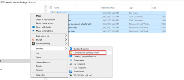

4.3 Invoice image as an attachment
Now it's essential to understand where the Invoice image or the Invoice file is placed. From the export package, you would notice the folder Resources > Vendor Invoice document attachment. Similarly, create one for the import process.

Now you can zip the folder to create a import package for this test.
Note: In a real-world solution, the source system should automatically zip the files after generating them.

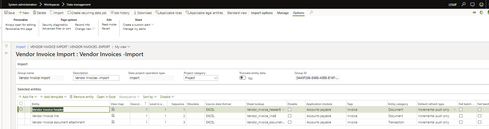

4.4 Import data using data management
Now we go back into the Data management workspace to create an import project using the.ZIP file as an import package.
The import automatically configures the entity lines based on the manifest in the data package, including the invoice document attachment on the header of the invoice.

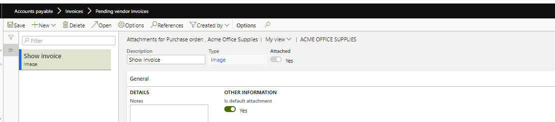

4.5. Default attachment
If a vendor invoice has more than one attachment, you can set one of the documents as the default attachment on the Attachments page.
The Is default attachment option is a new option that is as part of this feature.
This option is also exposed in the Vendor invoice document attachment data entity. Therefore, the default attachment can be set through integrations. Only one document can be set as the default attachment. After you set a document as the default attachment, it's automatically shown in the attachment viewer when the invoice is opened. If you don't set any document as the default attachment, the viewer doesn't automatically show any attachment when the invoice is opened

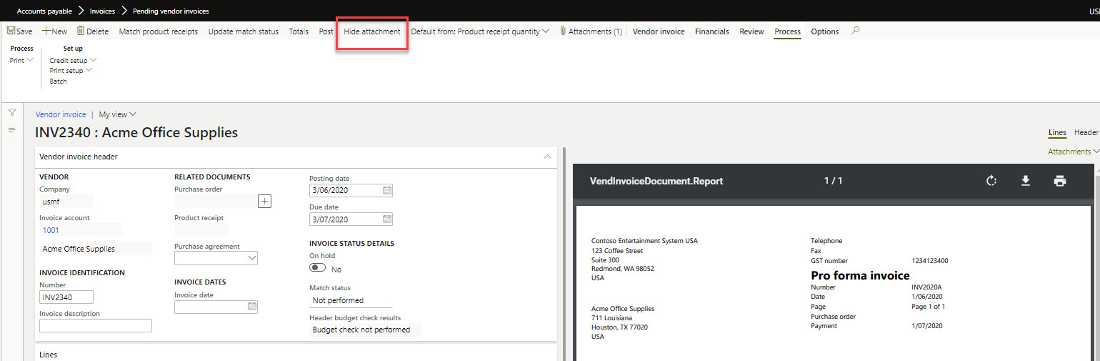

4.6 Show/hide invoice attachments
A new button that is available on the Exception processing, Pending invoice, and Invoice journal inquiry pages lets you show or hide the attachment viewer.
