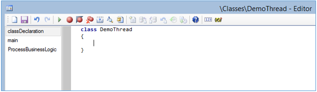

Create a class DemoThread.

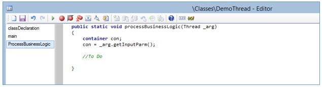

Create a method ‘ProcessBusinessLogic’. Ensure that the method is static as this will run in the Thread.

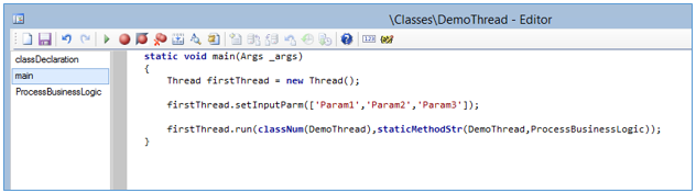

In the main method, create an object of Thread class, Thread firstThread = new Thread();
To pass the argument, you need to use ‘setInputParm’ method of standard thread class, which accepts the container data.
firstThread.setInputParm(['Param1','Param2','Param3']);
You then need to call run method of the thread class to assign a task to the thread. In the first argument, pass the class name and in the second, the static method name which you want to execute in the Thread.
firstThread.run(classNum(DemoThread),staticMethodStr(DemoThread,ProcessBusinessLogic);

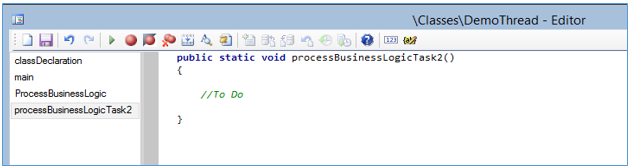

Now create another static method ‘ProcessBusinessLogicTask2’ to execute it in another thread simultaneously with the other task.

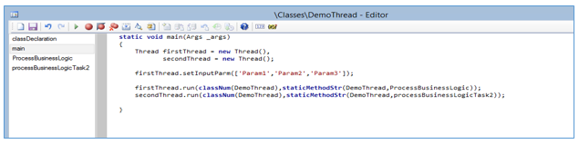

In the main method, create another object of the Thread class and then assign the task to this thread object to achieve multithreading.
secondThread = new Thread();
secondThread.run(classNum(DemoThread),staticMethodStr(DemoThread,processBusinessLogicTask2));
You will be able to see that the firstThread and secondThread run simultaneously.
