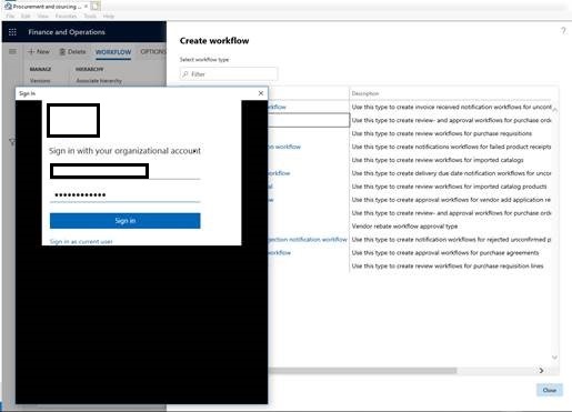

When I am trying to create a workflow, I got this error after installing the ClickOnce application.
Then I checked the ADFS event viewer and the error was
The received 'redirect_uri' parameter is not a valid registered redirect URI for the client identifier: '67ae0dc4-5f97-4c38-b132-65d38bbab8d1'. Received redirect_uri: 'dynamicsaxworkfloweditor/'

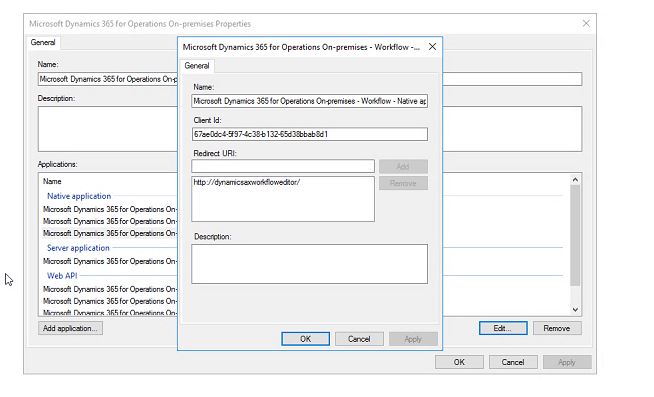

After checking the Client  '67ae0dc4-5f97-4c38-b132-65d38bbab8d1' (The one mentioned in the error) it was the Microsoft Dynamics 365 for Operations On-premises - Workflow - Native application.
I found that the redirect Uri has only http://dynamicsaxworkfloweditor.
I added the https://dynamicsaxworkfloweditor/  to the redirect uri.
That's it !!
