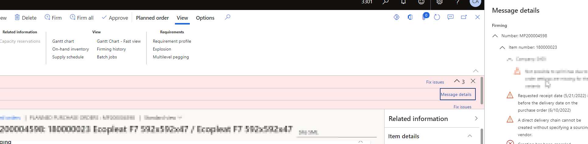

    I'm trying to get the MRP to create all purchase orders, whereas they are Direct Delivery or not.
    So far I didn't find how to - when trying to firm the planned purchase order, I get an error message "A direct delivery chain cannot be created without specifying a sourcing vendor".
    As far as I know, sourcing vendor can be added on the sales order line, but then the purchase order is created instantly and that's not what I want - I want all purchase orders to be created by firming a planned purchase order.

    Yes, the default vendor is filled.  If flows to the planned purchase order.  I have the "sourcing vendor" message in spite of that.
