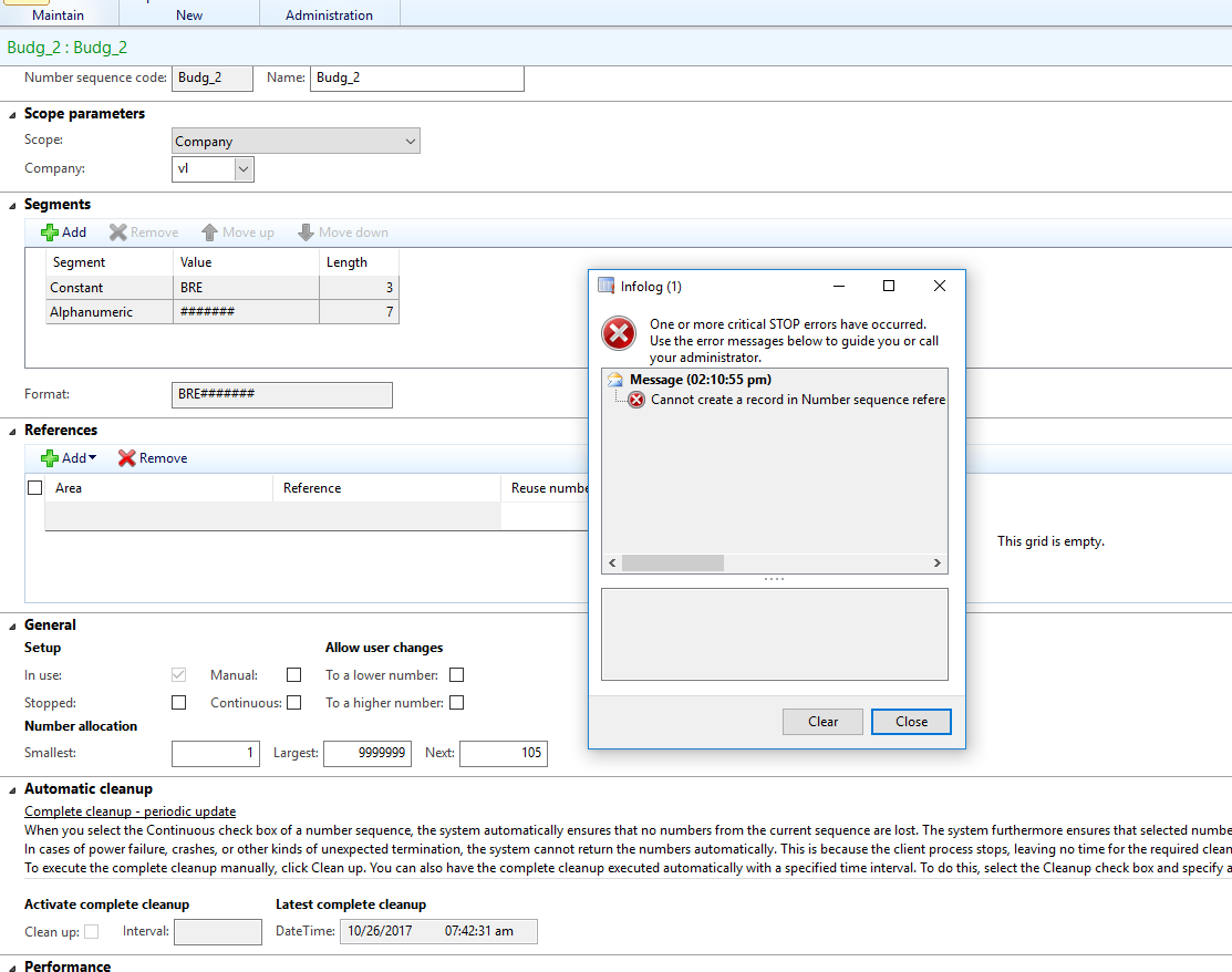

    We have a user in Finance department who uses the Budg_2 sequence number to create  BRE transactions.  He accidentally blanked out the Budg_2 and hit close.  When he went back in it was gone and he tried to put it back in but it gives an error message:
    Number sequence Budg_2 is not a continuous number sequence.
    This was at Budgeting > Budgeting parameters:  Please see my two screens and additional information below.  Thanks!  Sally
    number sequence error message
    Then I went to Organization administration > Number sequences> number sequences.  I searched for *Budg* and found my Budg_2.  I went into the Budg_2 in edit mode.  If i try to add the budg_2 back into references I get the same error.  What can I do to get this Budg_2 back into the first screen above?  thanks for your help with this!
    trying to added a reference that already exist

    Hi Sally -
    Close (Red X) is an implicit Save with no message.  I prefer to Escape.
    The Continuous field is below.  Some area of D365FO/AX require a Continuous setup.
    Was the user in the Parameters | Number Sequences when they blanked out the field?
    Thanks....Dave

    + if the organization does not continuous number sequences better to evaluate and disable in GL parameters
