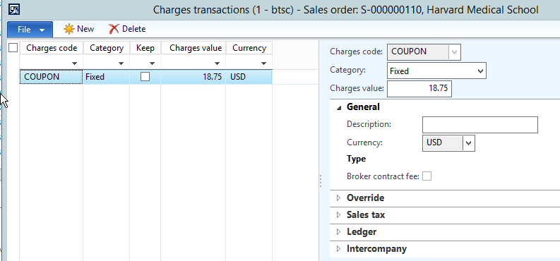

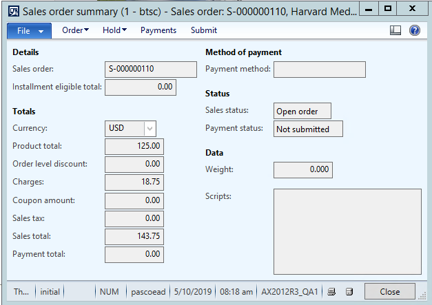

    When applying a coupon and completing the order the coupon shows up as a "charge" instead of a "coupon", raising the price of the order instead of discounting it.  (See screen shot below)
    We are using the call center functionality.  Reasonably certain I have everything configured correctly.

    Sales order summary, note the "charge" instead of "coupon amount"
    Sales Order charges
