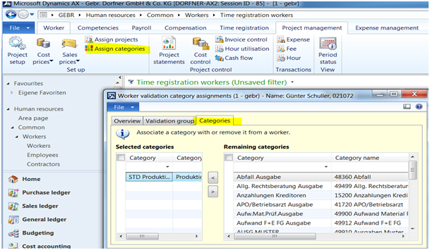

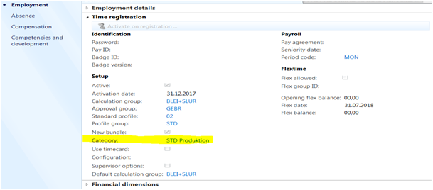

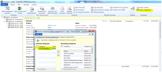

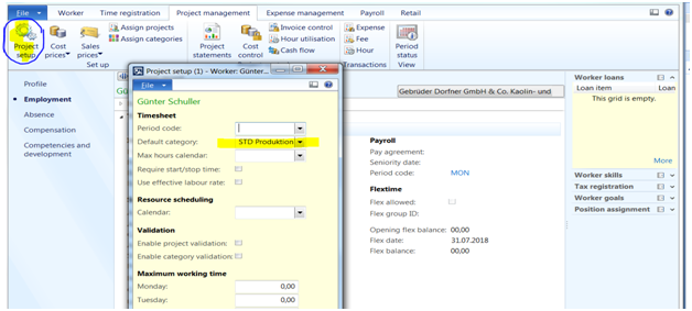

    I already tried to delete this category an set at
    • project management and accounting the category as followingproject management
    • human ressources the category as following three methods:
      Human resources/Common/Workers/Time registration workers/Employment/Time registration/Setup time registration human ressources
      Human resources/Common/Workers/Time registration workers/Project management/Set up/Assign categoriesHuman ressources assign categories
    Human resources/Common/Workers/Time registration workers/Project management/Set up/Project setup/Default categoryproject setup human ressources
    None of these settings fill in automatically the category "STD Produktion" at the approve.

    Your screenshots, though, look like it's not the hours/capacity you're trying to book, but the category applied, meaning either you want the cost calculated differently (such as using the production rate/rules instead of project rate/rules) or because you want the calculated costs to show up in project reporting with a different label (category name). That's a different set of tricks. You'd have to make sure the category definition(s) are check-enabled for both projects and production. For example, if you defined a category in the production module, there's a checkbox enabling "share with projects", and if enabled, you'd be prevented from creating a project category over there with the same name. If you create a category within the project module, the checkbox is "share with production" and follows similar rules.
    Once you've got the categories defined (and rates in either/both modules set), then it looks like you're trying to make sure that when reporting labor in time/attendance is done, it "chooses" the right production or project category. That's going to depend on whether the person is charging time to a production job/operation or to a project activity. If charging to a project activity, then the "choice" is dictated by the whole series of defaults in project module, the project type, the project itself, the activity, and the employee ID. If charging to a production order job/operation, then the "choice" is determined by a different series of defaults including production and MES parameters, resource group, resource (and remember, a resource can also be configured to map one-to-one to an HR employee, which can have BOTH production/MES defaults AND project management defaults).
