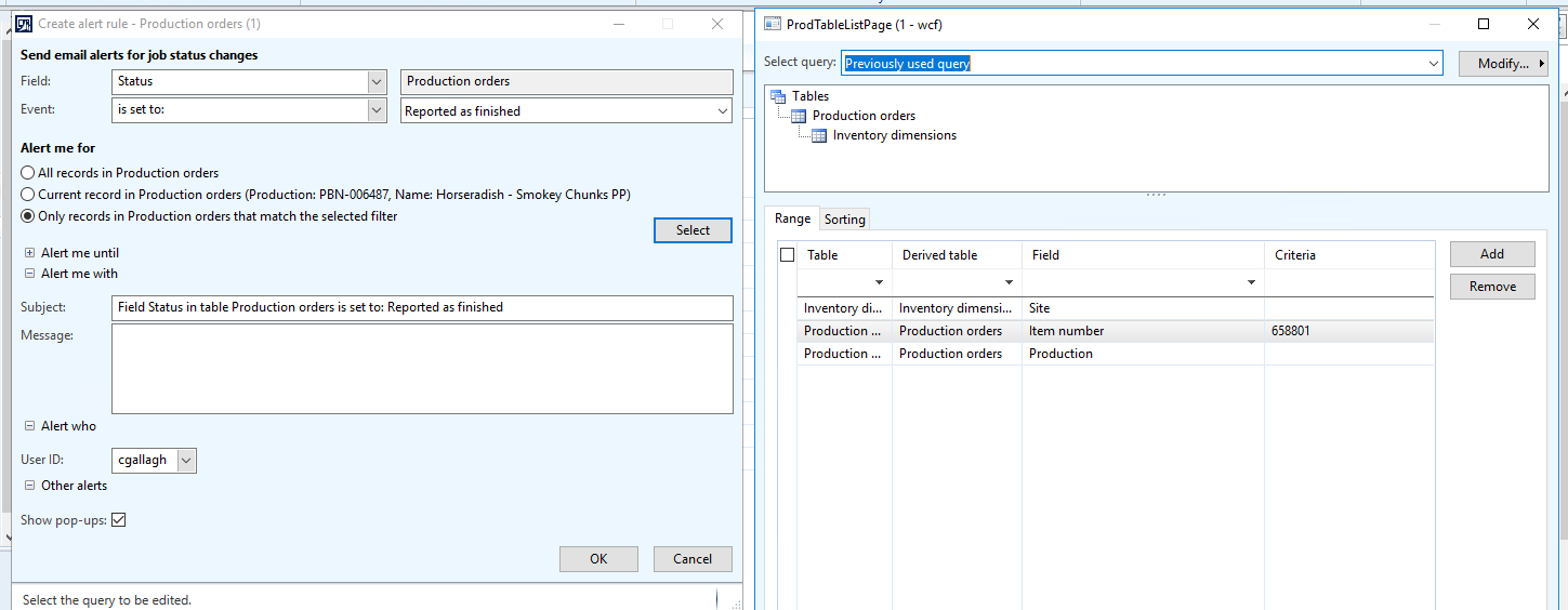

    For the first option:

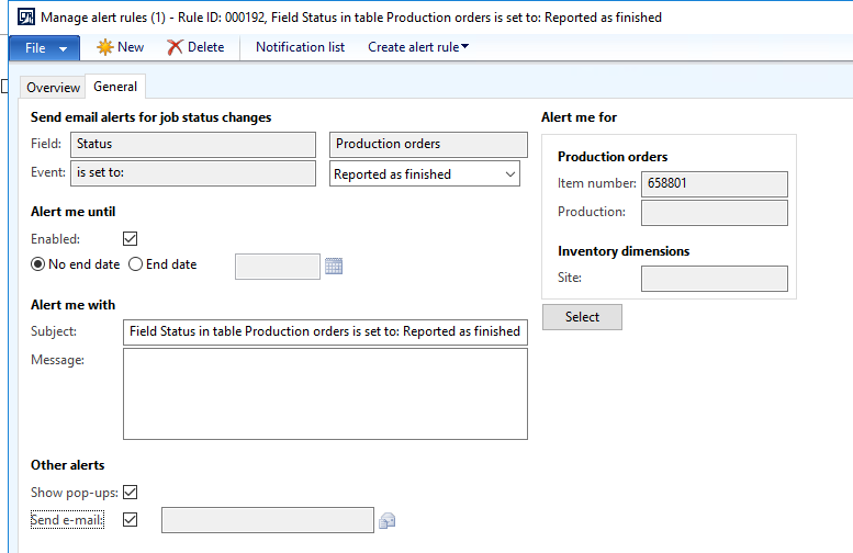

    1.) Go to All Production orders -> Right mouse click on "Status" column -> Create Alert Rule.  This should open the Create Alert rule window with the field set to "Status".
    2.) Change the "Event" to "Is set to:" and "Reported as finished" to the right.
    3.) Set the "Alert me for" to "Only records in production orders that match the selected filter", then use the Select button to enter your criteria of items.
    4.) Optionally change the subject line of the email, then close the Create alert form.
    5.) Now on the "Manage alert rules form", switch to the general tab and tick the "Send email" checkbox and you're done.

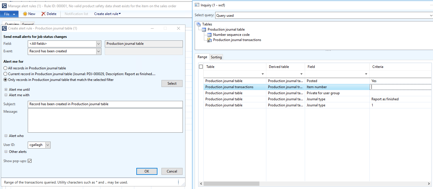

    For the second option:
    1.) Go to Production control -> Journals -> report as finished -> Change the filter to "All" -> right mouse click  anywhere -> Create alert rule.
    2.) Change the "event" to "record has been created", the "field" will change to "<All fields>".
    3.) Alert for "Only records ..that match the selected filter" and hit the Select button again.
    4.) On the top of the query, right mouse click on "Production Journal Table" and select 1:N -> Production Journal Transactions.  This will add the Production Journal transactions table to your query so you can set criteria on the items you are concerned about.
    5.) On the Range tab at the bottom of the form, add a row for table "Production Journal Transactions" and field "Item number".  Enter your items you are concerned about.
    6.) Once your done with the query, close until you get back to the Manage Alert Rules form, switch to the general tab an tick the "Send Email" box like above.
